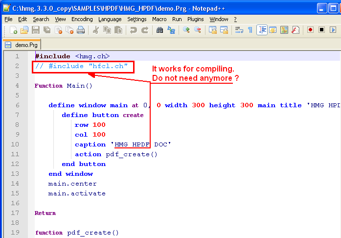

I have two questions about C:\hmg.3.3.0\SAMPLES\HPDF. This new folder actually support following examples:
- Demo1
Demo2_UniCode
HMG_HPDF
HMG_HPDFUNI
This new HPDF was moved from HFCL because HPDF now is considered out from HFCL ?
Or it was a missunderstanding ?
I ask about it because according what is was settled in this message (script for new samples folders structure) the C:\hmg.3.3.0\SAMPLES\HPDF folder should be at C:\hmg.3.3.0\SAMPLES\HFCL\HPDF.
I said "HPDF now is considered out from HFCL" because also I noted that putting as comment (disabling the line) at source code as follows: So, if is the case HPDF is not part of HFCL anymore, we can cut off #include "hfcl.ch" in all HPDF examples, right ? Please, may you confirm ?

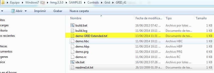

Until Dr. Claudio Soto can make changes in the IDE, we can not use long name at SAMPLES...
Re: HMG 3.3.0 (Stable)
entonces es necesario que haya un archivo de texto indicando el demo en la carpeta.Pablo César wrote:Yes Daniel, It will be a good idea. It could be done future demos with new naming projects having long-names at nomenclature of project names, but... IDE doesn't accept this yet...danielmaximiliano wrote:For improvement in HMG needs to stop calling DEMO_xx.XXX examples and pass it really is called the sample.
example: c:\hmg.3.3.0\samples\grid\demo_40\GRID Extended.hbp
or c:\hmg.3.3.0\samples\grid\GRID Extended\demo_40.hbp
as it now allows the inclusion of spaces in the file name / folder.
this is to know that the demo does not have to compile one on one example and see what it does.![]()
then there must be a text file indicating the demo folder.
- 2014-06-13 23_32_55-GRID_41.jpg (42.84 KiB) Viewed 21974 times
