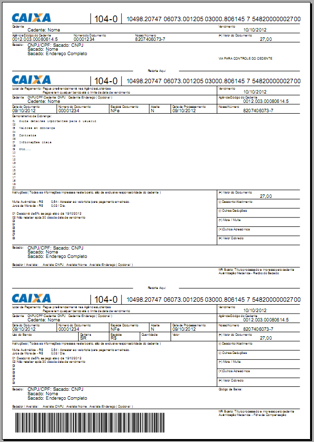

- A real documment using hbHPdf and hbZebra...
- Capturar.PNG (115.88 KiB) Viewed 5829 times
