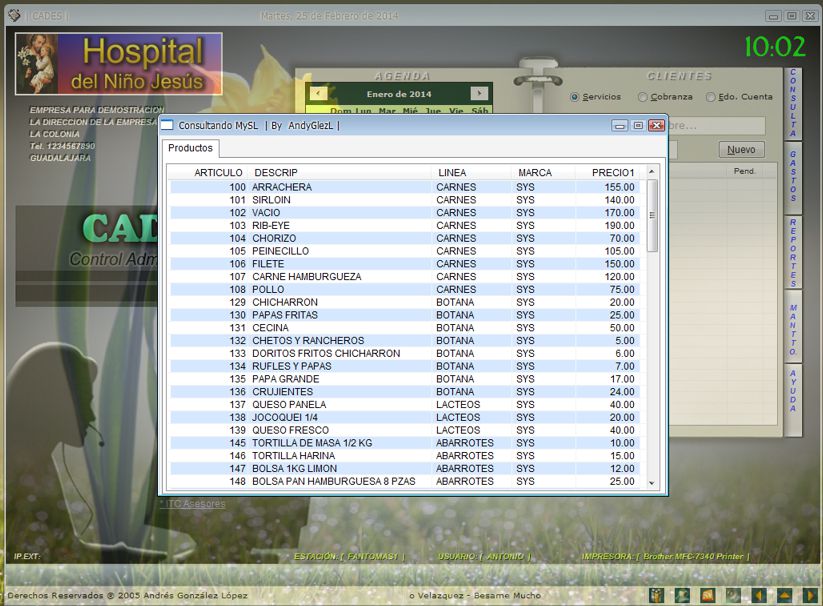

Estoy probando conectarme a una DB de MySql y utilizo las siguientes funciones
(en HMG 3.1.5 no tengo problemas)
Hello Rathinagiri
(sorry, had not seen the message)
I'm trying to connect to a MySql DB and use the following functions
(HMG in 3.1.5 I have no problems)
(perdón, no habia visto el mensaje)
Hello Rathinagiri
dbo:=Connect2DB('localhost','Adm528','','MyBusinessDelta')
aTableCol:=SQL(dbo,"DESCRIBE prods")
aTableDat:=SQL(dbo,"select "+cCposQuery+" from prods order by articulo")

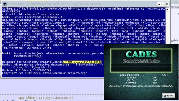

Rathinagiri, ya la incluí y me dice que no encuentra "iscontroldefine()" pero en mi fuente
yo no la utilizo, hago un #include "Gridtopdf.prg" y ahi si existe, la cambie por "iscontroldefined()"
pero aun asi me sigue dando el error de que no la encuentra ???
Rathinagiri, and included it and tells me not found "iscontroldefine ()" but my source
I do not use it, I do a # include "Gridtopdf.prg" and then if there is, it is changed to "iscontroldefined()"
but still still gives me the error that can not find it??

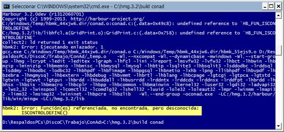

Re: HMG 3.2 (Stable)
vuelvo a compilar con la 3.1.5, (con los cambios hechos en "Gridtopdf.prg")
y si me funciona !
I again compiled with 3.1.5 (with the changes made in "Gridtopdf.prg")
and if it works!
y si me funciona !
and if it works!
- IsControlDef2.jpg (72.89 KiB) Viewed 25719 times
Maybe you have incremental compilation turned ON. you must remember to reset incremental data sometimes...
