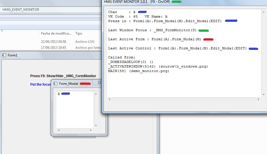

Hi Boys.
This is the power of event handling, HMG now can read the keyboard and intercept virtually all windows messages before they reach the application. :D
Try the example with the EXE file, tomorrow I prepare a patch with the upgrades.

Re: HMG 3.1.4 (Test)
srvet_claudio wrote:Hi Boys.
Thank you, Sir
Please include code to create log file also
