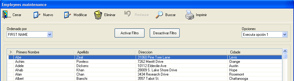

Gustavo, your indication is totally different as I have suggested. Please note this example:

Please return if your tests was made with sucess, otherwise I can send my executable file to prove that is working the way I have indicated.
You can make this PRG in C:\hmg.3.1.3\SAMPLES\EDIT_EXTENDED folder just for testing.

Compilé en Minigui puro y el resultado se mostró perfecto para mi, fijate:
En verdad no tengo experiencia alguna con mezclar HMG y Extended. Tenés alguna razón de mantenerte con Extended ? No puedes pasar al HMG ?
Compiled in MiniGUI pure and the result was perfect for me and pls note:
In truth I have no experience whatsoever with HMG and Extended mix. You have any reason to stay with Extended? You can not go to HMG?
