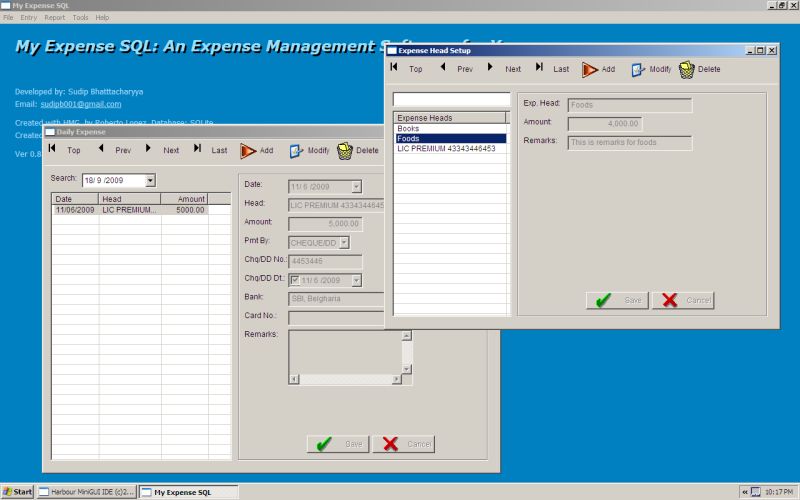

Hello Friends,
This is my first Sqlite real life project.
This is an update of my old MyExpense project. So, if it is installed in old Folder, it will automatically add existing data from dbf to Sqlite tables. I also added Backup facility (but, not Restore due to some problem. I can't use SQLITE3_CLOSE() function)
Please install from
setup.zip
(1.04 MiB) Downloaded 1124 times
And download source code from
MyExpenseSql.zip
(17.09 KiB) Downloaded 1124 times
And please don't forget to send you comments like before.
