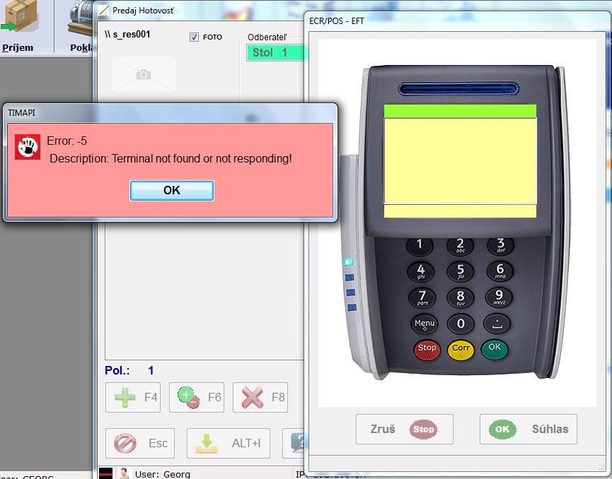

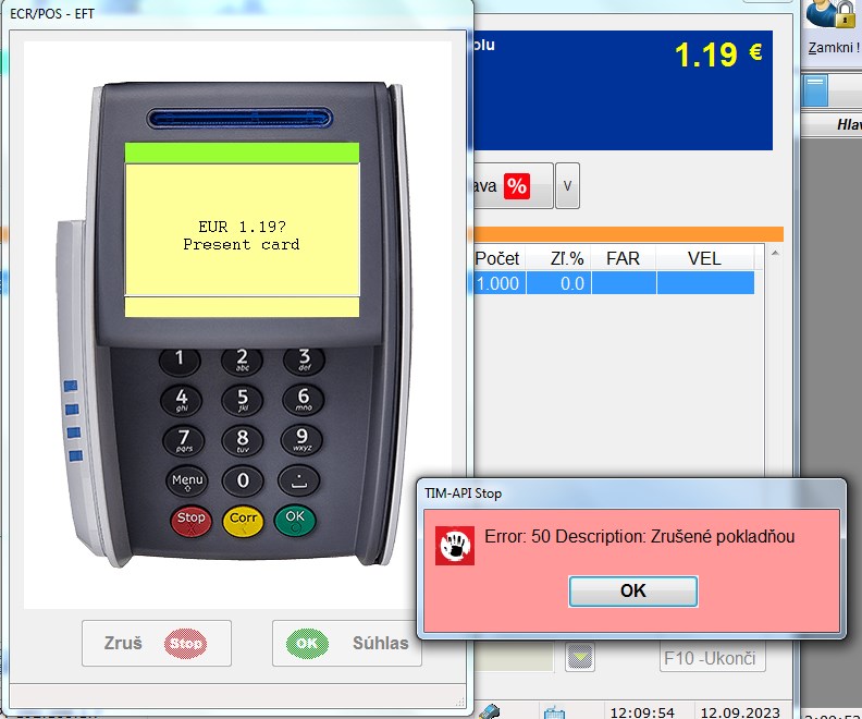

Hello,
I declare success, the certification is approved
I would like to thank Edward without whom this would not have been possible
I am attaching the final version, a selection from the program, which is certified.
There are also screenshots from working with the payment terminal.
