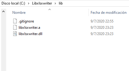

Jimmy:
Download Libxlsxwriter from the GitHub repositories.
install msys64
in windows run CMD
2020-07-09 23_22_52-Libxlsxwriter.png (20.17 KiB) Viewed 10146 times
DLL and .a were generated
2020-07-09 23_32_33-lib.png (4.97 KiB) Viewed 10146 times
libxlsxwriter.rar
(889.57 KiB) Downloaded 280 times
