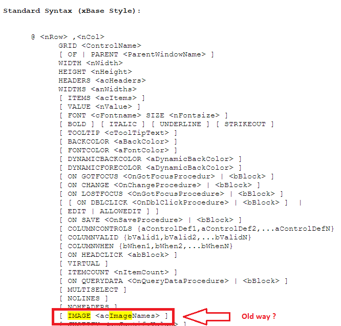

More one question Claudio about images in grids.
Please confirm my understanding, these image adding ways:
<ParentWindowName>.<GridControlName>.Image ( lTransparent ) := { "image1.png", "image2.bmp", ... } -> New way :?:
and
This last is old way :?:
Posts: 2220
Re: Function InputWindow()
Pablo César wrote:More one question Claudio about images in grids.
and
Yes, the last image is the old version and the first the new way.

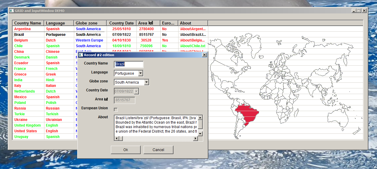

InputWindow for in-place-edit in Grids Finally I got satisfactory results with more than 45 Grids tests (all Grids demos at SAMPLES and some more) as promissed to Rathi (his great idea) with an alternative to in-place-edit feature in Grids, using InputWindow with a minimum implementation efforts to users and without any degradation or slowness on the Grid.
Some considerations:
  1. InputWindow will not replace any data in the grid.
    The main idea is to pass to edit all fields in the grids thru InputWindow and returning results in array to be handled by the programmer as be wished to entire responsability.
  2. InputWindow Implementation at grid I indicate to do it thru ON DBLCLICK grid event.
  3. InputWindow can be implemented at grid by these different ways:
    1. InputWindow() (without any parameter). It will detect by itself all grid properties.

New features at ColumnControls was added and enhanced:
  1. DatePicker with two options: DROPDOWN or UPDOWN
  2. TimePicker with different options: _TIMELONG24H / _TIMESHORT24H / _TIMELONG12H / _TIMESHORT12H
  3. Spinner with:
    • Two parameters: nRANGEMIN and nRANGEMAX
    • Three parameters: nRANGEMIN, nRANGEMAX and nINCREMENT (this last is new)
Some interesting features:
  1. ColumnWhen make exceptions edtions. Preventing edition by enabling controls becoming in gray when attend the condition. This could be done by following ways:
    • By using This.xxx. Example: { This.CellValue == .T., This.CellValue > CToD("01/01/2000") }
    • By using a simple array containing logical value for each column. Example: { .T.,.T.,.F.,.T. }
    • By using a function with more elaborate features. Example: { CheckValid(This.CellValue),CheckAge(This.CellValue) }
      Anyway is good to test all the logical compose. Try first with EDIT at grid to check results before.
  2. Hiden fields (not displayed and not editable) can happen with:
    • For retrocompatibility, it has been reserved the first column where index list be used for images display at grid.
      New way to display images at grid have been implement at grid. What's the most indicated use.
      Please check Image ( lTransparent ), ImageIndex ( nRow , nCol ), ImageList and also HeaderImageIndex for the right usage.
    • Sometimes we want to hide a particular column. Could be one o more, which can be useful for data processing but not be editable column/field. In these cases, you just put value 0 (zero) at the respective column in <anWidths> of grid.

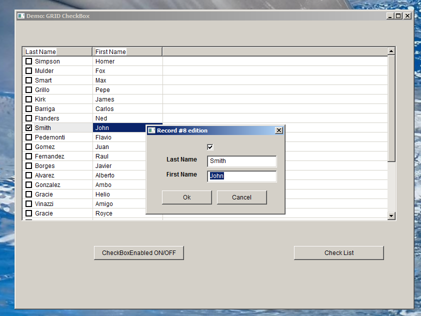

  3. Implement a new composite field CheckBoxItem for selectable items. Which is not a separated field but count when be cheked/filled. This is always the first field in edition. No label was applied, due of many languages for internalization.
  4. When is double-clicked at any column of grid ( even for not CellNavigation ), will be started at correlative field thru SetFocus. This is useful to go direct to the most ineterest field to be edited
  5. Allows fields edition even for MultiSelect records in grid. Will be act in two differents ways:
    • When is double-clicked in just only one row/item, all values will bring to be edited.
    • When more than one are selected items, will open an empty values.
      This is useful when we wish to be replaced specific field for many records.
  6. Label were been optimized by it width size. Taking the maximum length of header's string.
  7. When anWidths parameter have not be informed at InputWindow calling, this will take the exact width of each column automactically.
  8. InputWindow will take the same sequence of columns at grid. Even if grid was with sorted order column, will take the corresponding column.
  9. When is resized width colum at grid and entered to InputWindow, this will also resize control correlative of that column. Useful for column with EditBox extending the width of column.

Here in attached is one example (source codes and executable file):
Grid_CheckBoxes.rar
Grid_CheckBoxes demo (source and executable file)
(1.12 MiB) Downloaded 300 times
