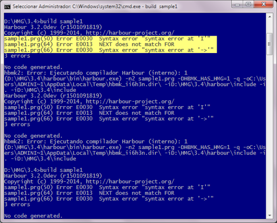

Hola Mol
Asi de primer intento lo probe pero da error
Hello Mol
So I tried it first attempts but fails
Hello Mol
- sample1.png (193.33 KiB) Viewed 5026 times
