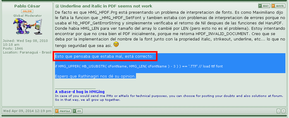

I found a difference in h_HMG_HPDF.PRG source file.
In _HMG_HPDF_PRINT function definition, some piece of code from line 283 looks like that:
 If HMG_UPPER( HB_USUBSTR( cFontName, HMG_LEN( cFontName ) - 3 ) ) == '.TTF' // load ttf font
In _HMG_HPDF_MULTILINE_PRINT function definition, adequate line (no. 372) differents from above:
If HMG_UPPER( HB_USUBSTR( cFontName, HMG_LEN( cFontName ) - 4 ) ) == '.TTF' // load ttf font
Difference is in recognizing .TTF extension. First line is good, second is bad.
I've changed 4 to 3 in line 372, recompiled library, and it's work OK to me.
I'm testing forward.
It's a bug to correct in the next version of HMG, I think.
Regards, Marek

Yes Marek, you are right !
I have published this solution at viewtopic.php?p=35144#p35144 because EduardoLuis has appointed this same fail.
Even with solution in our hands, nothing happen at new releases.
Only strong discusions about this... :(
