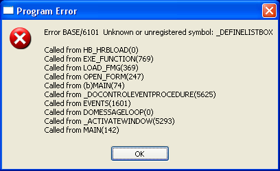

Now I'm struggling with a lot of difficulties to operate the functions on the following components:
_DefineListBox
_DefineSlider
_DefineMonthCal
_DefineIPAddress
Something about these extern recognizing from Harbour / HMG that seems to behave differently.
At first I thought I might include a single include file and then had included the MiniGUI.ch because it is all files are included in that. But this is not the case. It's not about includes, because this is usually good interpreted.
Simply does not recognize following functions:
_DEFINELISTBOX
_DEFINESLIDER
_DEFINEMONTHCAL
_DEFINEIPADDRESS
An error is displayed when is being to execute thru hb_compileFromBuf/hb_hrbLoad.
I am stressed with this. I hope somebody could to see what it could be happen with these components.
In attached, it is the source code of today. with errors and code much tweaked...

I am still looking for a solution for these components... So for whom is interested to try to be solved this problem, I attached Main1.fmg which contains those components. Main.fmg, working ok.
