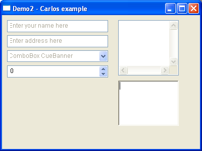

In midle of way... but I can say it working in XP SP3 not in XP SP2 (at least on my pc) and Spinner did not worked at all. I saw Spinner handle return an array with two elements (by MsgDebug) I have tested both handles and nothing about cuebanner in this component. In ComboBox is working.

Here you can see in WinXP SP3:

Your cue.exe example Carlos, is working but on WinXP SP3 not in SP2.

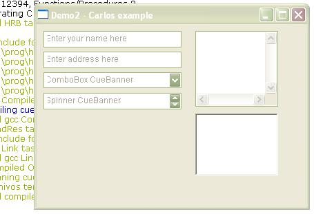

This is a capture of your sample with my changes on XP sp3.
Compiled with hmg 3.1.2
