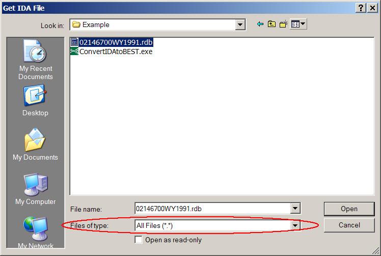

8. Imageforgotten to implement for 5th parameter in function PutFile (old claim from Mr. Esgici) and new suggestion for extra 6th parameter. The 5th parameter in InputFile will be usefull for default file name and would added a 6th parameter (passing by referance) just know which File of Type have been choosen from user, as follows:

Pablo César wrote: 8. forgotten to implement for 5th parameter in function PutFile (old claim from Mr. Esgici) and new suggestion for extra 6th parameter. The 5th parameter in InputFile will be usefull for default file name and would added a 6th parameter (passing by referance) just know which File of Type have been choosen from user...
Done !!!
  PutFile ( acFilter , cTitle , cIniFolder , lNoChangeDir , cDefaultFileName, @cExtFile ) --> cSavedFileName

You want it, here it is: :)
Remember:
cExtFile := NIL ---> Not set selected file extension (traditional behavior)
cExtFile := "" ---> Sets the file extension selected by the user
Function Putfile ( aFilter, cTitle, cIniFolder, lNoChangeDir, cDefaultFileName, cExtFile )
LOCAL cFilter:='' , n, cFileName
   IF aFilter == Nil
      aFilter:={}
   EndIf
   IF cTitle == NIL
      cTitle := ""
   IF cIniFolder == NIL
      cIniFolder := ""
   IF cDefaultFileName == NIL
      cDefaultFileName := ""
   FOR n := 1 TO HMG_LEN ( aFilter )
      cFilter = cFilter + aFilter [n] [1] + CHR(0) + aFilter [n] [2] + CHR(0)
   cFilter :=  cFilter + CHR(0)
   cFileName := C_PutFile ( cFilter, cTitle, cIniFolder, lNoChangeDir, cDefaultFileName, @cExtFile)
Return cFileName

Posted: Thu May 23, 2013 2:30 am
Thank you dear Claudio !
It is working perfectly ! Better than suggested, because cExtFile return true of extension name, even selecting extension or typing extension name...
Very good, excellant ! Thank you again !
