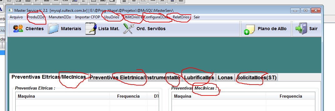

hello I'm having trouble with accents. I installed version 3.1.2 of HMG following image like this my system

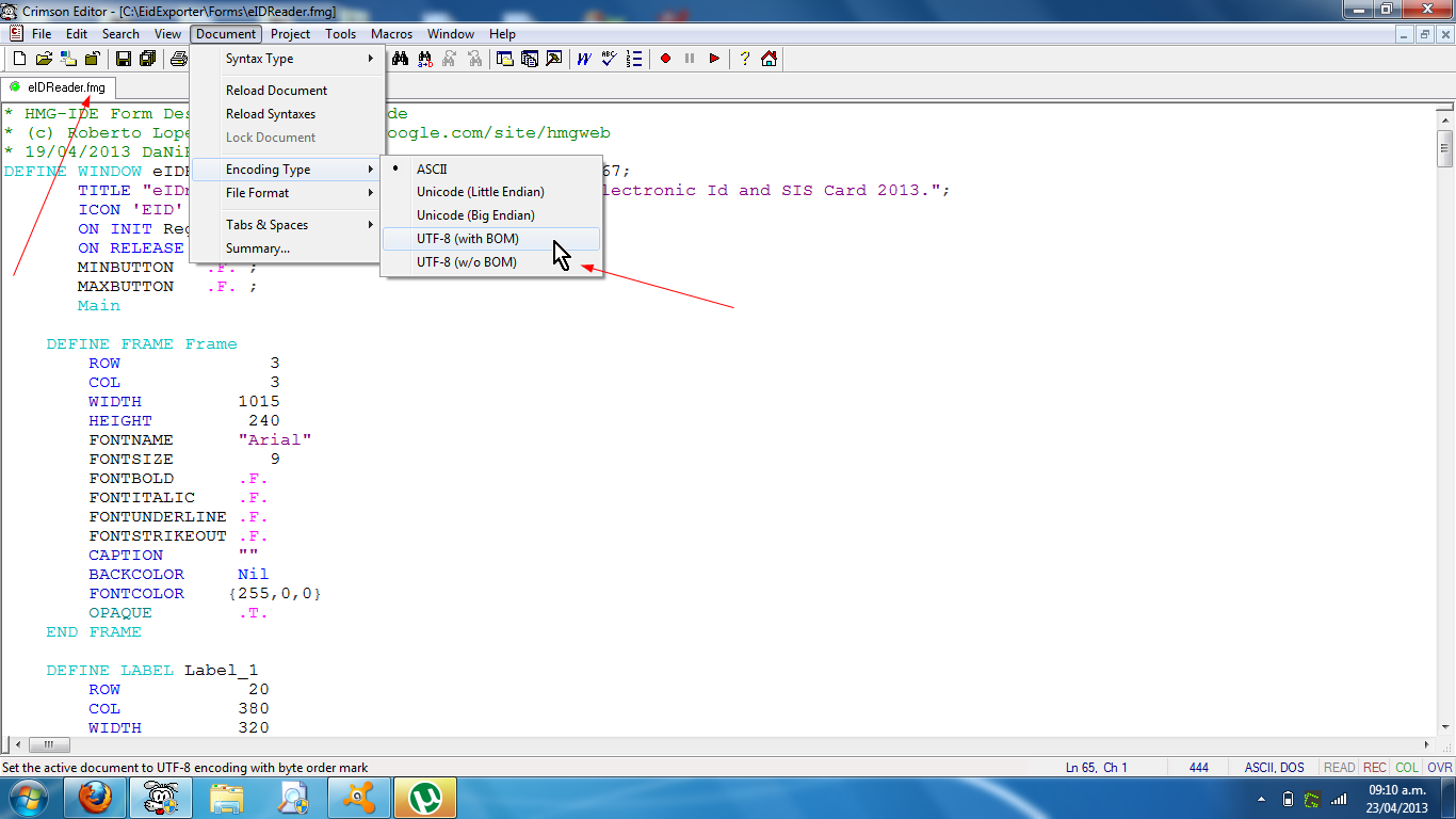

Amigo, falta você configurar o seu editor para o padrão UTF-8. Isso se já colocou o Set Language to Portuguese.

Portugues:
Ola Pablo mas o problema seria no formulário da IDE, esta escrito com acento normal porem quando compila fica com caracteres estranhos
Inglês:
Hello Pablo but the problem would be in the form of IDE, it is written with an accent standard however is when compiling with strange characters

new forms created with HMG IDE are in ANSI format, should have an option in the IDE to change the Encode leaving default for new forms, I have to open all forms created through the IDE with an editor and convert to UTF8 to stay with correct characters.

I believe the problem is in IDE which creates a frm files in ANSI format. But we have not source codes of HMG/IDE, so if you still are using fmg files, you can edit with Notepad++ en UTF-8 format correcting brazilian accents and save file.
Re: HMG 3.1.2 (Test)
Try to modify the forms with the publisher, on entering search and replace to change the character and the character it replaces, I use that and is more practical.

It was exactly what I did, open the files fmg and converted to UTF8, but this should be done by the IDE to new forms or an option in preferences that could choose a standard UTF8/ANSI etc..

I'm working on the conversion of the IDE to support the Unicode character set.
