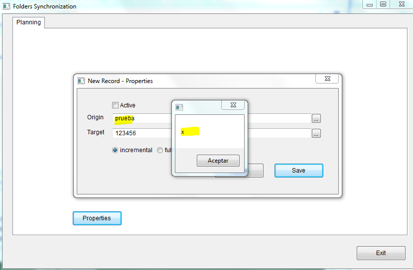

Something is happen with textbox control, randomly their value is not returned.
See next example:
1- Run prueba.exe
2- Hit Properties button
3- Hit Save Button
Save button execute the next code:
cTemp:=GetProperty('Win2','Text_1a','Value')
msgbox(alltrim(cTemp)+"x")
But in a randomly manner the value is not returned, sometimes msgbox shows: "Pruebax"
And sometimes only shows "x"
Attached please find short example
Thanks for your advices
Ed
Prueba.rar
(1.37 KiB) Downloaded 1403 times

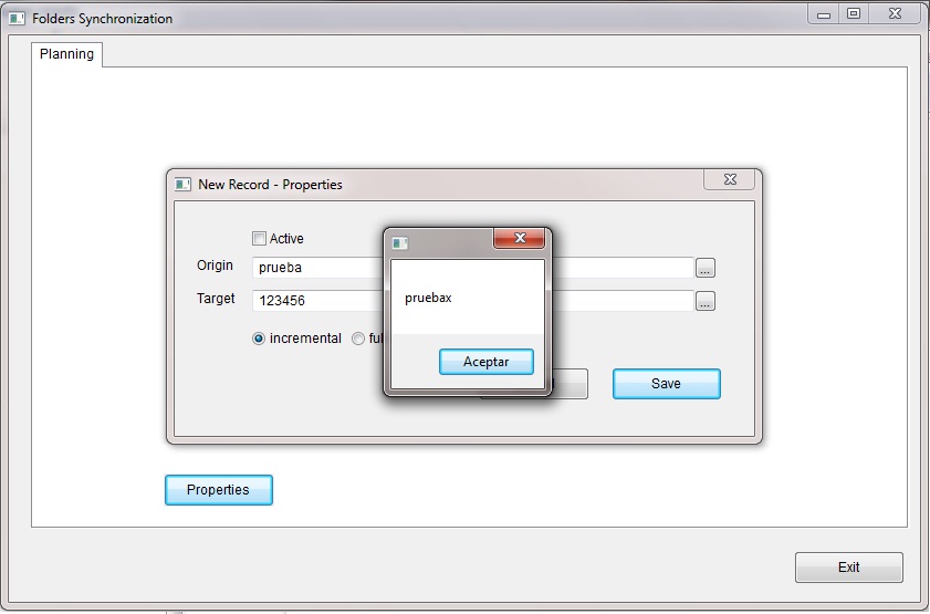

Hola...
Ya lo Compile y responde bien en HMG.3.1.1
Te mando la imagen... y lo ejecute 10 veces... y todo Ok, si tienes problemas desintala el HMG y vuelvelo a instalar, revisa de virus tu compu...
Polo
Hello ...
Compile and already responds well HMG.3.1.1
I send you the picture ... and run it 10 times ... and everything Ok, if you have problems and vuelvelo Removes the HMG-install, virus checks your compu ...
Polo

Steed wrote:Hi, all
Ed
I also happen to Incomming Email application.
SetProperty ( 'Incomming' , 'cUser' , 'value' , 'danielmaximilianoherrera' )
SetProperty ( 'Incomming' , 'cPass' , 'value' , '123456' )
however this does not happen with
SetProperty ( 'Incomming', 'Title' , 'Current : ' + aServers [ Incomming.Server.value] [ 1 ] )
Textbox control fails many times, thought I had a Rootkit / Malware but I check many times and nothing.
HMG.3.1.1 also reinstall several times.
in some executions control returns the actual content.
Windows 7 Home Premiun 64
Steed

HI,
I allready download again HMG.3.1.1 file from the forum and recompile the example
bud the issue reamaind
I Have W7,
Ed

Pues no veo el error, tengo win7-32 y ejecuta bien tu archivo...
Polo
Well I see the error, I have win7-32 and runs well your file ...

yo uso Windows 7 Home Premiun 64.
I use Windows 7 Home Premium 64.

Thanks, Daniel I still having the same problem.
Does anyone could confirm the issue with textbox
Ed
