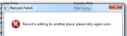

Hi Richard
Something like this does will help you ?
Screen shoot for Edit Extended with pre-lock
EditRExtCB19.zip
Source files for Edit Extended with pre-lock
(37.99 KiB) Downloaded 329 times

Hi Esgici,
Very nice job, I just had the time for a quick first look... some rermarks:
1. When a user Cancels or OK a record that is edited the record should be immediatly UNLOCKED (I think it stays locked until other record is selected)
2. When a user intends to add a NEW record (append blank) other users get (sometimes) RECORD LOCKED. Other users must do another append blank and lock that one.
The way it works now, only one user can enter new data.
3. When deleting a record I sometimes get: "record locked by another user" (something left from original code?)
4.. The text could be: Record is locked by another user; please try again.

I had a little more time and figured finally out how the .CH system works.
I already corrected points 1 and 4.

Hello,
Included is zip file containing changes for Prelock of records in multuser network:
1. When opening dbf check is made to see if file is not exlusively in use by someone else.
2. When adding, deleting and editing a record it is locked before action
and unlocked when saving (or cancel) the action.
Richard
