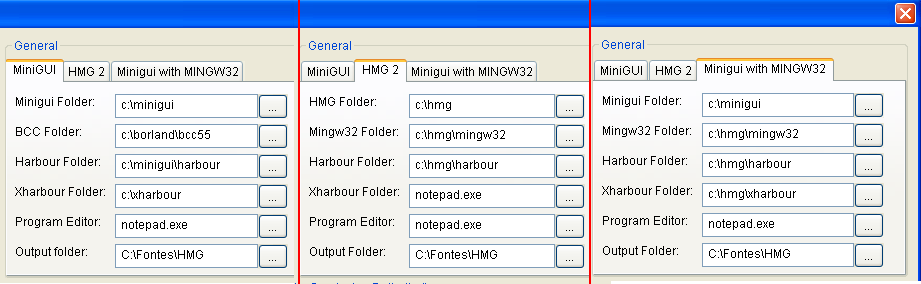

So it was diferent situation when compile with HMG Extended IDE. I understand that it is possible with some more options, like to build with Harbour in pure console with BCC thru HMGE IDE. It will be very good for our HMG IDE to get same resources, like picture shows below:
Is it possible to build our HMG apps thru HMG Extend IDE ? At moment I do not know if my configurations at "Tools/Preferences" are correct, I means for paths of each tools. My MiniGui, Harbour, BCC and HMG are installed in the default path at installations. Could it be confirmed if can it be used for HMG and if configs. are ok ? As shows Screen captured below:
I believe that having a good development environment, reduces much reworking and be more practical. Sorry if I body you, but what do you suggest to me ?

Sorry Mr. Esgici, now I have attached images files for display proposes.
