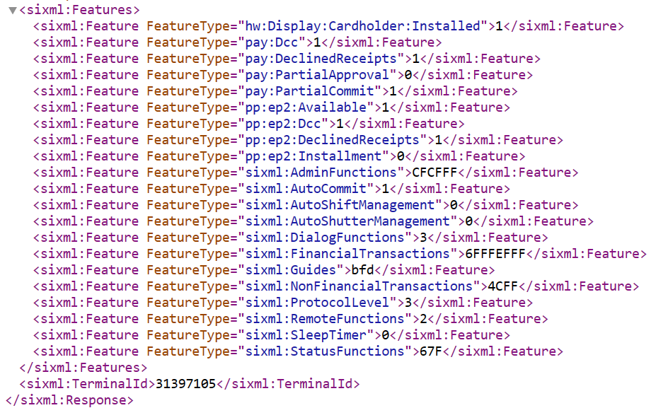

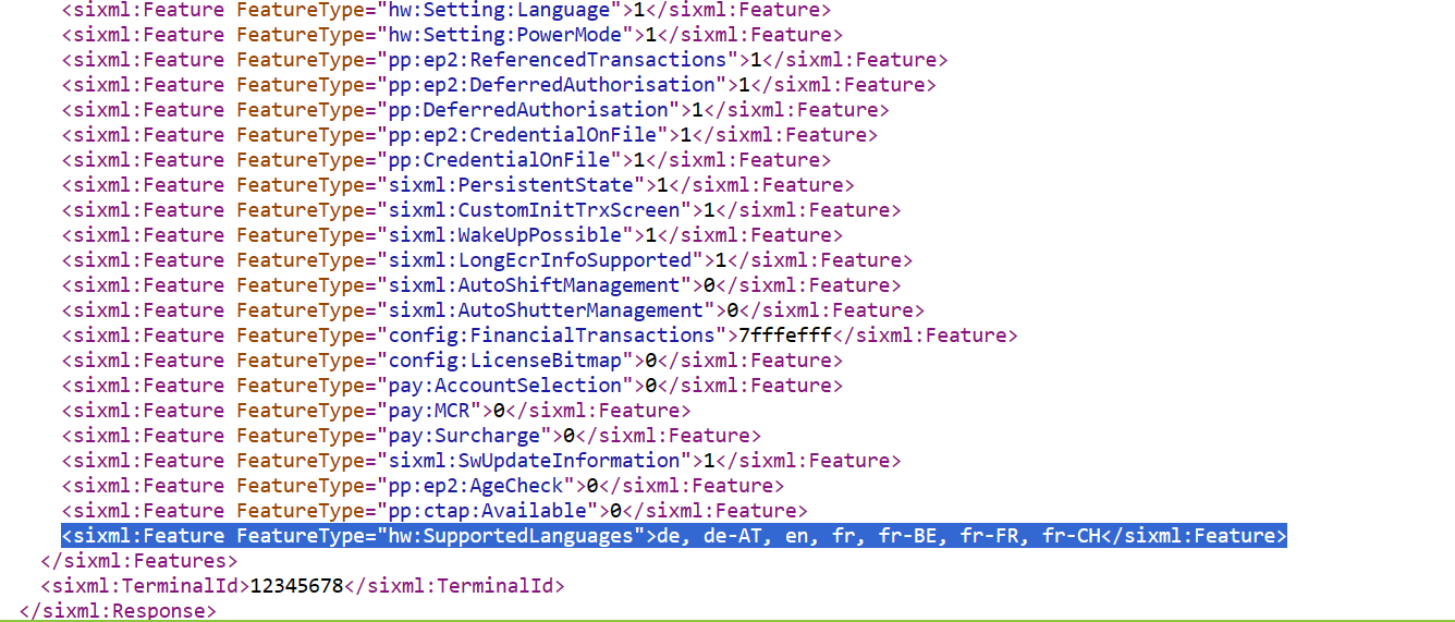

As for changing the language, I have no way to check if it works. I don't have examples from AdvancedEcr.exe so I relied on .Net code
I didn't find a direct reference to ta_terminal_get_supported_languages, but found something like:
				{ FeatureType.Enum.HardwareListSupportedDisplayLanguages, "hw:SupportedLanguages" },
In the simulator these values are returned:
, but in your EFT they are not. :!:
To read these values use the GetSupportedLanguages() method

Hi Edward
Great work again.
Your modification of the TIM_CardInfo function works 100%
GetSupportedLanguages() returns an empty array.
I created an array with values that are in SupportedLanguages {'de','en','sk'} and used that as a parameter of the ChangeLanguage ( oTIMAPI ) function.

edk
Posts: 999
Re: Payment terminal TIMAPI.DLL
Post by edk »
Yes, I know that the terminal returns the language set in the terminal when querying "SystemInformation". But how to force change this language?
In turn, sending the ChangeLanguage ( cLangID ) notification, according to this description:
The ChangeLanguage-notification changes the current cardholder language of the EFT.
It is intended as a way of changing the cardholder language during transactions or dialog interactions, e.g. if a cardholder uses a language selection mechanism of a unattended device.
This is a best effort function.
Language string is either two or five letter long. Two-Letter Format: The two letters are a ISO-639-1 language code. E.g. da, nl, ... Five-Letter Format: The five letters are a combination of a two letter language code, a dash, and a two letter uppercase country code as recommended by RFC 5646. E.g. de-CH, fr-BE.
, should change the language during the transaction. From what I understand, if the card has such a language selection mechanism :?:
From the logs you sent, your test card only has the language "en".
