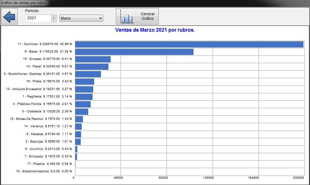

Hi, sorry i keep asking about this, but i don't understand what happening...
With the values put "by hand" in the array the same thing happens, this part of the code fails (capture in the previous post)
aData := {228870.00,118823.08,35779.00,33545.00,26101.00,19070.00,18231.50,17521.00,15675.00,13329.20,7970.00,6761.10,6194.40,5656.50,2414.00,1970.00,450.00,0.00}
aLeg := {"1","","","","","6","","","","","","12","","","","","","18"}
	oObj := GraphPlus():New()
	With Object oObj
	  :GraphData := aData
	  :Legends   := aLeg
	  :ShowLegends := .T.
	  :LegendPos := 0										// 0 = Derecha	/	1 = Abajo
	  :Width := 994
	  :Height := 514
	  :Title := cTitle
	  :Picture := "999999999.99"							// Mascara para los valores
	  :ShowLabels := lLabels								// .T. = Muestra los valores
	  :GraphType := GT_PIE
	  :Draw()
	  Chart_Pie.Image_Chart.hBitmap := :Bitmap()			// Imagen con el grafico
	EndWith
Sort or not sort values in "aData", show or not show labels, always fail
With another values (same len 18) no fail, What i do wrong ? Maybe 18 is too long for pie chart ?
What's wrong with those values, maybe 228870.00 to 0.00 it's too much difference ?
Any help is welcome, Thanks in advance !

Thank you very much Serge, It must be an overlay problem, I think 18 data is a lot, I solved it with a bar graph.

May be because of 0%?

Thanks for reporting!
Confirmed the bug. If the data is so small that its portion comes to 0 degrees when rounded, there is a problem.
Now changed the code in such a way that, if it is 0 degrees, it will not be shown. Hope it is ok.

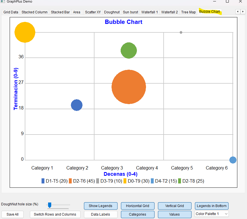

New type added, bubblesImage
GraphPlus_Bubbles.zip
