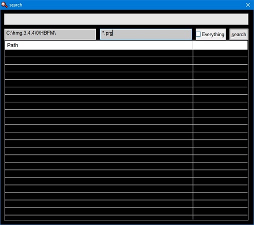

ALT-F7 with "normal" search (and Everything if installed )

v.0.85 17.04.2020 ALT-F7 search in File

ALT-F7 now can search Text "in" File. F3/F4 and Ctrl-F for search RTF and TXT (PRG)

v.0.95 17.05.2020 search in ZIP

ALT-F7 search in ZIP

search in ZIP does not work with Everything
