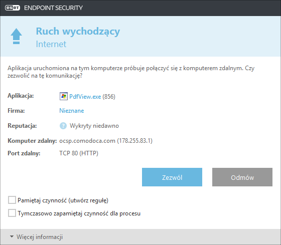

I tested the application with my client, who has win8, works fine, but when starting PdfView.exe, FireWall detect strange network traffic:
Strange, because the computer has Eset protection, not comodo.
KDJ

edk wrote: Mon Mar 27, 2017 11:26 am I tested the application with my client, who has win8, works fine, but when starting PdfView.exe, FireWall detect strange network traffic:
Probably some bug in Eset Security.
Edward
