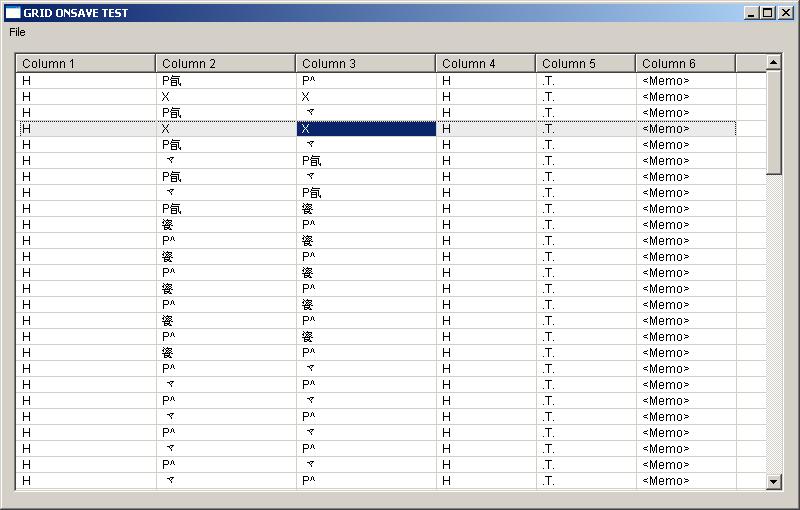

各位老师您们好,
当我使用UNICODE 的库对C:\hmg.3.4.3\SAMPLES\Controls\Grid\GRID_34\的例子编译运行时,Grid一切正常。但是当我使用ANSI库重新对这个例子编译运行时,如果对cell单元格进行编辑、翻页操作时,GRID就会显示出现混乱(在中文WINXP和WIN7环境下都一样),不知是不是我的中文WINDOW操作系统的原因,还是GRid有BUG?
Dear teachers, you are good,
When I use the UNICODE library to compile and run the example of C:\hmg.3.4.3\SAMPLES\Controls\Grid\GRID_34, Grid everything is normal. But when I used the re to compile and run this example, if the edit cell, page turning operation, the grid will display confusion (in Chinese WinXP and win7 environment are the same), I do not know the reasons for the than my Chinese Windows operation system or GRid bug the ANSI library?
HUIYI
HUIYI
- ansi_build_run.JPG (74.79 KiB) Viewed 8222 times

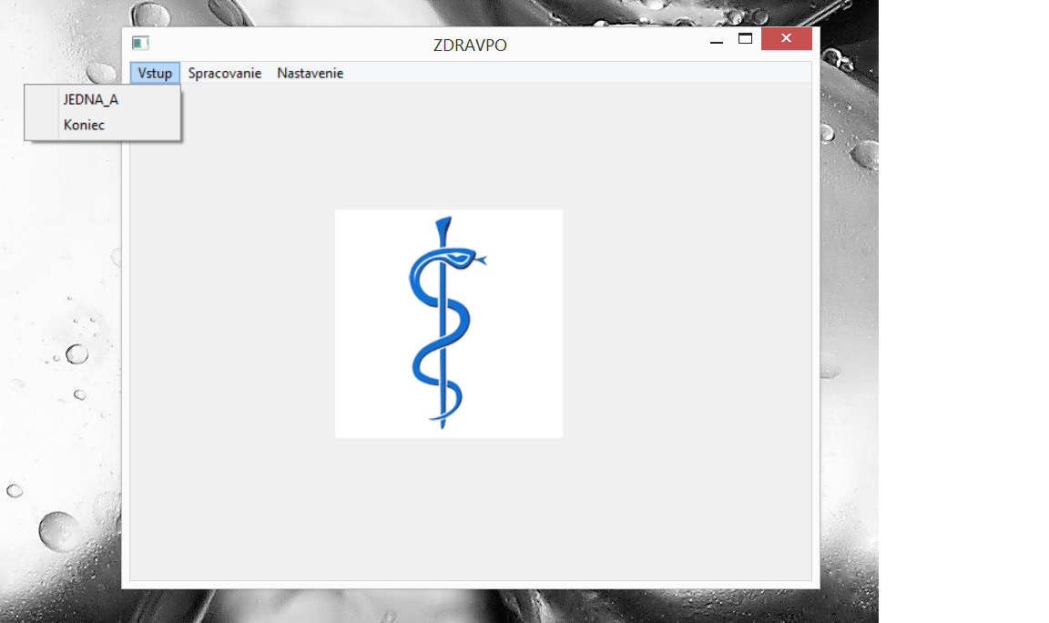

Hello,
when I compile program with HMG version 3.4.3, I got strange display of main menu - outside from main window (see attached picture).
How can I suppress this behavior?
Thanks
Jozef
Thanks
Jozef
- menu.png (241.79 KiB) Viewed 8080 times

Hi Dr. Claudio and Team:
我找到解决HMG ANSI模式下,编译运行APP,网格出现乱码的办法了!
修改函数SETGRIDQUERYDATA(文件 c_grid.c ,第746行):
I find the method to solve the issue when compiled app in ansi mode the grid display junk.
change the original function :SETGRIDQUERYDATA(file c_grid.c,line 746 ) for this:
HB_FUNC ( SETGRIDQUERYDATA )
LPARAM lParam = (LPARAM) HMG_parnl (1);
LV_DISPINFO* pDispInfo = (LV_DISPINFO*) lParam;
// HMG_Trace( __FILE__, __LINE__, __FUNCTION__, _TEXT(" %p |- %s -| %d "), pDispInfo->item.pszText, (TCHAR*) HMG_parc (2), pDispInfo->item.cchTextMax, NULL );
#ifdef COMPILE_HMG_UNICODE
if( hb_iswinvista() ) // Is Win Vista or newer // ADD3, September 2015
lstrcpyn(pDispInfo->item.pszText, (TCHAR*) HMG_parc (2), pDispInfo->item.cchTextMax); // ADD3, July 2015
pDispInfo->item.pszText = (TCHAR*) HMG_parc (2); // Is Win XP
#else
#endif
Then rebuild libraries(ansi and Unicode). Now app works fine.
#else
#endif
