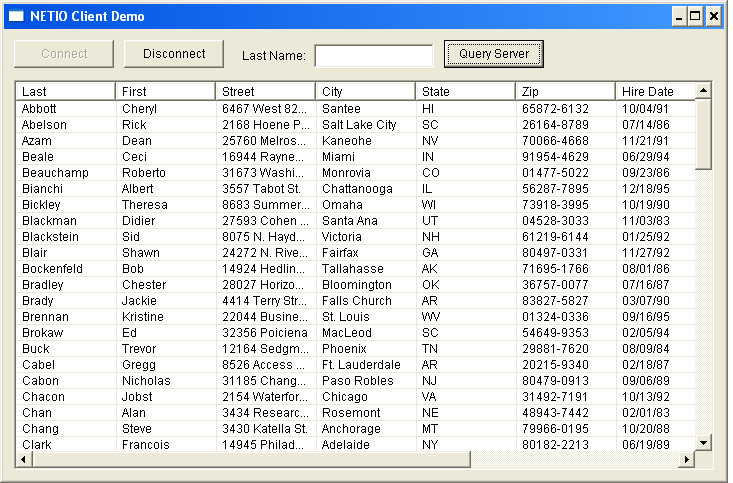

Hi All (Specially Claudio
I'm still working on the NETIO demo that includes a virtual Grid now.
It works perfect when built with 3.0.40, but building it with 3.4.1 it shows garbage on grid from the second query (the first query works ok).
I've not tested with other versions.
The OS is XP PRO SP3 32 BITS.
What am I missing?
Thanks!
What am I missing?
Thanks!

Hi Roberto,Roberto Lopez wrote:Hi All (Specially Claudio),
What am I missing?
Thanks!
Please change in file c_grid.c (line 135) the original LISTVIEW_SETITEMCOUNT function for this version:
HB_FUNC ( LISTVIEW_SETITEMCOUNT )
HWND hWnd = (HWND) HMG_parnl (1);
INT nItemCount = (INT) hb_parni (2);
if ( (GetWindowLongPtr (hWnd, GWL_STYLE) & LVS_OWNERDATA) == LVS_OWNERDATA )
ListView_SetItemCountEx (hWnd, nItemCount, LVSICF_NOINVALIDATEALL);
ListView_SetItemCount (hWnd, nItemCount);

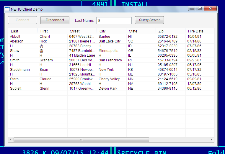

I've applied the patch and the problem remains (note the 'H's and the '@'s).srvet_claudio wrote:
PS: the behavior of LISTVIEW_SETITEMCOUNT changed when change the version of common controls used
- Image1.png (40.9 KiB) Viewed 5399 times
Re: HMG 3.4.1
After patch applied on my computer, attached is the resultRoberto Lopez wrote:I've applied the patch and the problem remains (note the 'H's and the '@'s).srvet_claudio wrote:
- err.PNG (34.67 KiB) Viewed 5391 times
