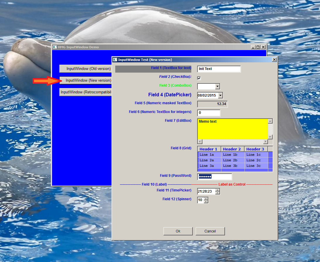

Function InputWindow()
New controls added TimePicker and Spinner already !
Spinners it will work with INCREMENT option.
Sources files and demo will be delivered with InputWindow2() upto an official version be released.
<Source code of DEMO5 was removed because there is a updated version ahead of this topic>
I hope you enjoyed ! :D

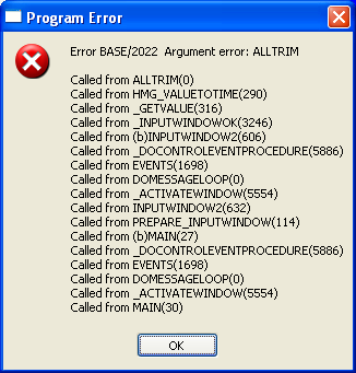

Hi
verify error
Thank you Dave to test and announce the runtime error.
The dificulty it was at TimePicker when aFormats parameter is passed as array.
Array + String was the available way. I know there is not need to be an array to pass hour type.
But it was the posible way to differentiated with the pre-existed items (other controls) in InputWindow();
So now I transform from array to string and is okay now.

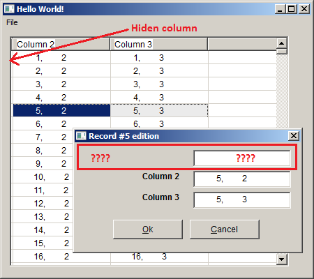

InputWindow is quite finnishing to edit Grid's records. I'm testing in several situations before release it.
One case is heating my head thinking case like as in C:\hmg.3.4.0\SAMPLES\Controls\Grid\GRID_03 demo.
The first column is with size equal to zero. Normally I have defined for this case like as default value for control widths.
An I wish to share with you to compose a common sense what to do in this cases.
I thought at begining to show (let's say TextBox) but be enabled=.F., but this definition I have already counted in ColumnWhen.
Then I ask to myself: What's finality of hiden column in Grids ?
To process something but can not edit, right ?
But also we do not wish to be displayed.
So I thought to define this column with hiden control, but it will take empty space on the screen.
See picture below to have an idea:
In this case label is empty and size was forced to default width.
What do you suggest ? Any ideas ?
Re: Function InputWindow()
Hola Pablo César!
Yo sugiero que no aparezca en el InputWindows la columna 1, ya que por alguna razón se oculto!
Tenés razón Javier ! Lo voy hacer asi. Voy a cargarlo y ocultarlo. Es decir el control podrá contener algun valor que puede ser útil para ser procesado, pero al control lo voy a esconder.
Gracias Javier por tu interés y respuesta.
Un gran abrazo

Pablo César wrote:InputWindow is quite finnishing to edit Grid's records. I'm testing in several situations before release it.
This is a defect in the implementation of GRID that I left it to maintain compatibility with older versions.
In old versions when displays images in the grid control the first column is used for display it and only in this column.
The correct way is display the image in the side of text in any column and not in a separate column.
- <ParentWindowName>.<GridControlName>.Image ( lTransparent ) := { "image1.png", "image2.bmp", ... }
- <ParentWindowName>.<GridControlName>.ImageIndex ( nRow , nCol ) [ := | -->] nIndex
