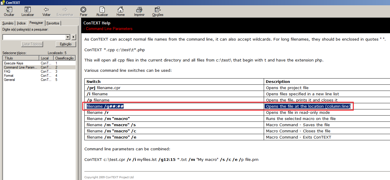

* If i select Context as my default program editor the program keeps asking me parameter for line no , ie "-n" of npp.
In your previous messages, you have mentioned something like context... (lower case I guess) and I did not imagining you was referring to a your favorite editor. :roll: (IMHO: "context" word it's dual meaning)
I have installed and now I know it. Very good one because has a Foxpro highlighter but I am still liking NPP.

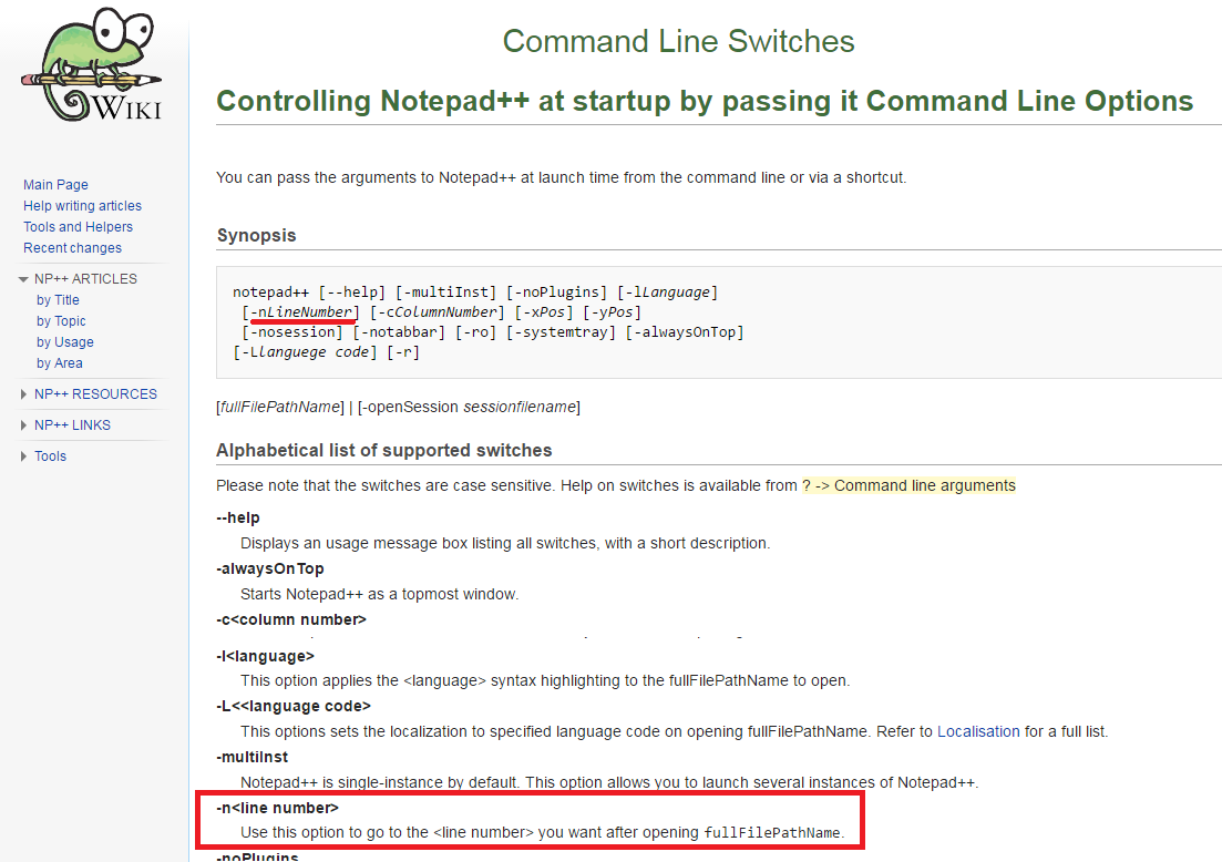

For this question of line parameter needing in Context editor you will need following info to ViewError's settings:
"/g1:"       (Without quotes)
See picture below:
For Notepad++, this parameterization for this same propose is:
http://docs.notepad-plus-plus.org/index ... e_switches
Earlier version did not ask about this parameter.
In this last version of ViewError its fundamental for proper work to exist this parameterization.

Thanks. The program is working now but it can't call the notepad++ to display the error message. So. I replaced the build.bat with the one you provided before and then the notepad++ can be called to display the error. But, I got another problem that it seems the hmgpath is not point out to my installation location "c:hmg.3.4.4"
How it is possible ?
Have you setted NPP as your favorite editor in "Preference" or by command line "/CONFIG" ?
Have you installed ViewError and then booted ?
May you explain what happining giving more details, please ?
No need to do this. Please keep original Build.bat because It is extremely necessary that it be the original file to this version 3.4.4.
