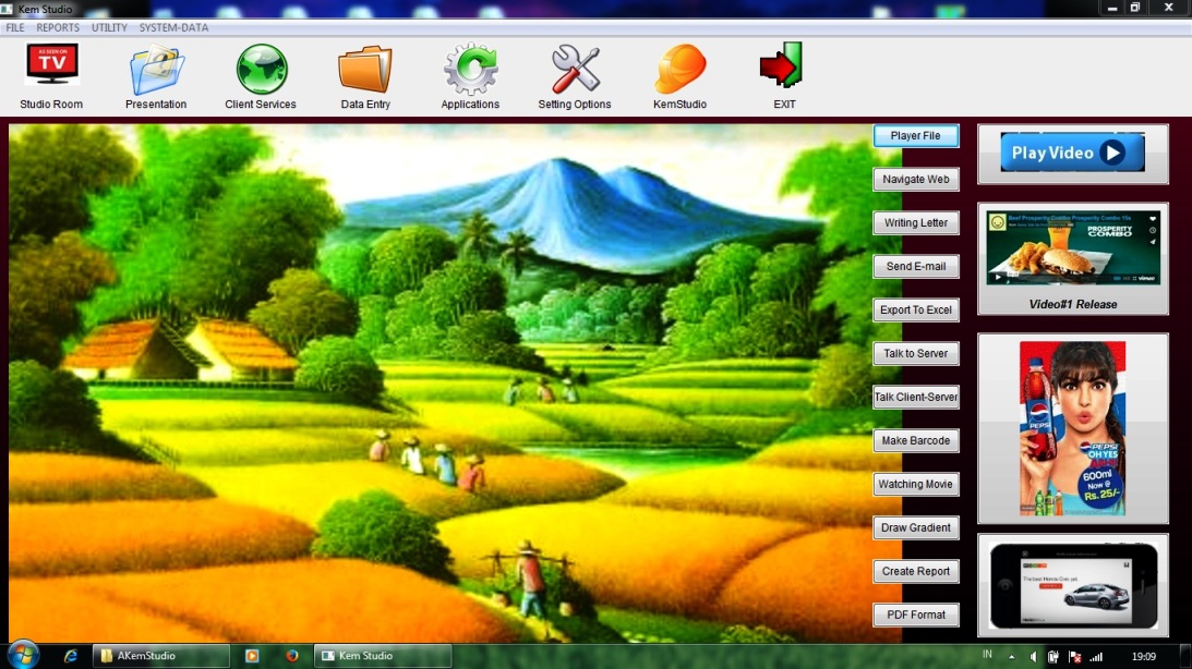

Hi All,
Special for weekend, I would like to show you the beauty of Indonesia's natural villages. Although it's only a paiting, it represents the real life. I make it as wallpaper for my first project developing application software with HMG.3.3.1.
Enjoy. Have a nice weekend.

Re: How To Help Clipper & Foxpro Users Catch Harbour-HMG ASA
Pls note:
- all images on the right side are sample only
- the wallpaper, credit to Jakarta-kata.com
