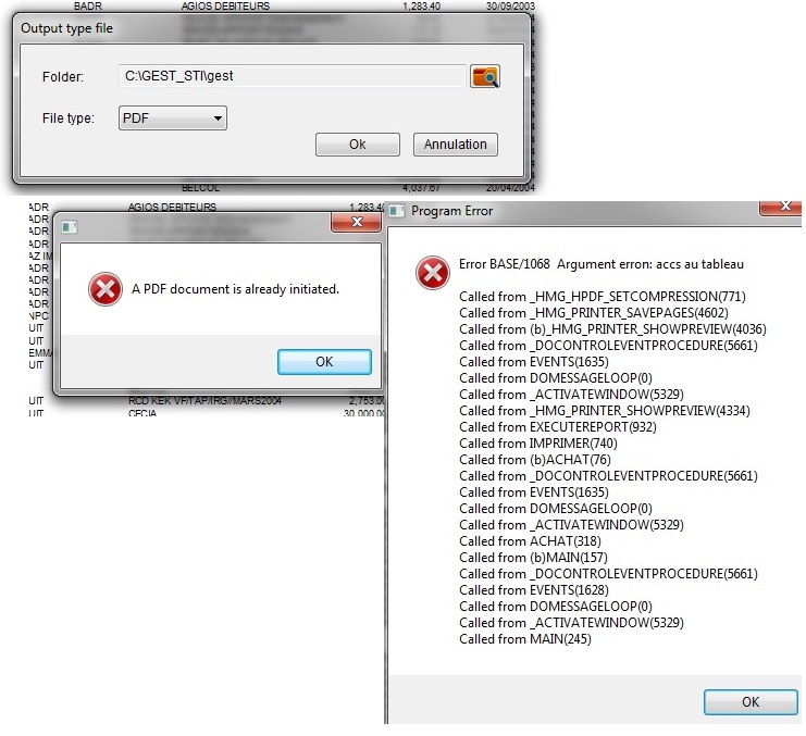

Hi to all,
When I want to save in *. PDF, I receive that Way
Thank's for your Works
L'Algerie vous salut
Y.TABET

HMG 3.3.0 (Stable)
tonton2 wrote:bonsoir
l'exemple est dans C:\SAMPLES\PrintSystem\reporttest
Merci beaucoup Thank's
Dear friend Rathi,
According all the examples under of C:\hmg.3.3.0\SAMPLES\Controls\ReportAdvanced and C:\hmg.3.3.0\SAMPLES\PrintSystem which making use of ExecuteReport function, located at C:\hmg.3.3.0\SOURCE\h_rptgen.prg. The array _HMG_SYSDATA [ 150 ] is in conflict with different array structure comparing what is creating at _HMG_HPDF_INIT function at C:\hmg.3.3.0\SOURCE\h_HMG_HPDF.Prg.
In C:\hmg.3.3.0\SOURCE\h_rptgen.prg is with single logical value and in C:\hmg.3.3.0\SOURCE\h_HMG_HPDF.Prg it is with a big structure like this:
_HMG_SYSDATA[ 150 ] := { ;
                        Nil, ;                  //  1.PDF Object
                        cPDFFile,;              //  2.PDF File to Save
                        0,;                     //  3.PDF PaperSize
                        0,;                     //  4.PDF PaperWidth
                        0,;                     //  5.PDF PaperHeight
                        nOrientation,;          //  6.PDF Orientation
                        Nil, ;                  //  7.PDF Current Page
                        'Helvetica',;           //  8.PDF default font
                        12,;                    //  9.PDF default fontsize
                        "StandardEncoding",;    // 10.PDF default encoding
                        {},;                    // 11.PDF Outlines Array
                        {},;                    // 12.PDF Pages Array
                        0;                      // 13.PDF Current Page Number
It is for this reason there presenting an error when try to convert Metafile to PDF. This when calling _HMG_HPDF_SetCompression( 'ALL' ) at C:\hmg.3.3.0\SOURCE\h_controlmisc.prg.
Please confirm if this difference is correct or this address for Generator Flag should be changed, in order to avoid misperceived :?:
IMHO, this Generator Flag should be stored at _HMG_SYSDATA [ 151 ] (Current Report PDF Object Variable, I checked and I see is not use at anywhere, non at all HMG source code) and changing from _HMG_SYSDATA [ 150 ]. This will be easy solved to change at C:\hmg.3.3.0\SOURCE\h_rptgen.prg (and nowhere else).
Re: HMG 3.3.0 (Stable)
We shall fix in the next patch. Thanks for the report friends.
