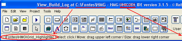

Re: HMG 3.1.5 - Improvements and corrections
Pablo César wrote: 10. From HMG Wishlist Project Path in IDE, this is an Esgici indication that shall need a third avaliation, because are two different suggestions and we have to see what is the best for all of us.
It's done, I opted for the suggestion of Esgici because I think is the best, the title bar of the IDE is already full and no longer fits more text.
srvet_claudio wrote:It's done, I opted for the suggestion of Esgici because I think is the best, the title bar of the IDE is already full and no longer fits more text.
Do not you think the title of the IDE is not necessary to be so large ? New ideas can be useful, improved and can be combined, may not ? Could accept both suggestions ?
I means... is it so necessary to have URL in the title ? Title also can give important details just when have several open projects and all IDEs sessions are minimized. By this suggestion we can see which one we wish to open:
As shows the image with both indications, you can choose previusly the right session of HMG IDE.
Make this happen ! ;)
HMG 3.1.5 (Test)
srvet_claudio wrote:the title bar of the IDE is already full and no longer fits more text.
I think so... but it could be changed ?
This IDE TITLE is what I think going to be best for now:
By the way Dr. Soto, after you have done the change in IDE (your patch), the statusbar is showing the project name parcially (not complete). This could be auto-adjustable ?
If not, there is another solution, because tere are two empties StatusItem of the StatusBar. One can removed and another could displays a IDE mode: UNICODE or ANSI. Then it can reduze size of a new IDE TITLE... ;)
