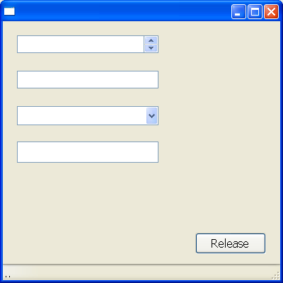

Hi.
the below attachments, capture and exe are on Xp.
The exe is not an HMG code but the related function SetCuebanner() is Almost identical. The exe is just to show the behaviour. The exe wwas compiled with harboour 3.2 and bcc but is the same with MinGW. Unicode and Ansi.
- capture in XP
- CAP1.png (4.48 KiB) Viewed 5605 times

Hi Carlos, thank you for your patience and contribution. But your exe here in WinXP SP2 lamentably not working...
Shall be SP2/SP3 the problem ?
In Win7 is working perfectly.

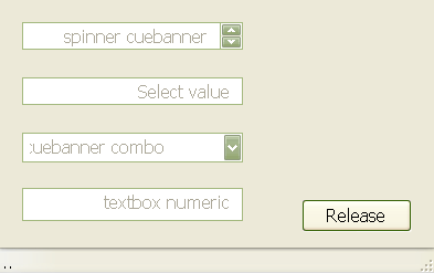

Please try with code
Note that:
in spinner GetControlHandle() return an array. So SetTextBoxCueBanner() need a trick to work.
in combobox I'm using FindWindowEx( GetControlHandle( "Combo_1", "Form_1" ), 0, "Edit", Nil ) to get the handle of textbox.
Note that:

Hi Pablo
En MSDN I saw this comment:
Maybe is the problem with sp2
Can you try if this is true for us ?wParam option note
wParam TRUE - only appears to work on Vista.
Under XP the cue text always disappears when the control gets focus regardless of this parameter.
