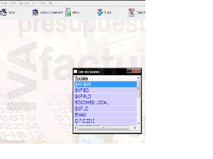

After rebuilding library and recompiling with 3.1.3 i have
problem with Grid . i use the ansi mode
foued

fouednoomen
Posts: 188
Location: Tunisia
Re: HMG 3.1.3 (Test)
Post by fouednoomen »
Dear Radhi ,
Look to the attached photo
foued

fouednoomen wrote:After rebuilding library and recompiling with 3.1.3 i have problem with Grid . i use the ansi mode
Grid data are in ANSI? You puts SET CODEPAGE TO ... ?
Please post a small example.

fouednoomen
Posts: 188
Location: Tunisia
Hi claudio
yes the grid is in ANSI
I PUT set codepage to french it don't work HMG IDE display mistakes when i compile
foued
