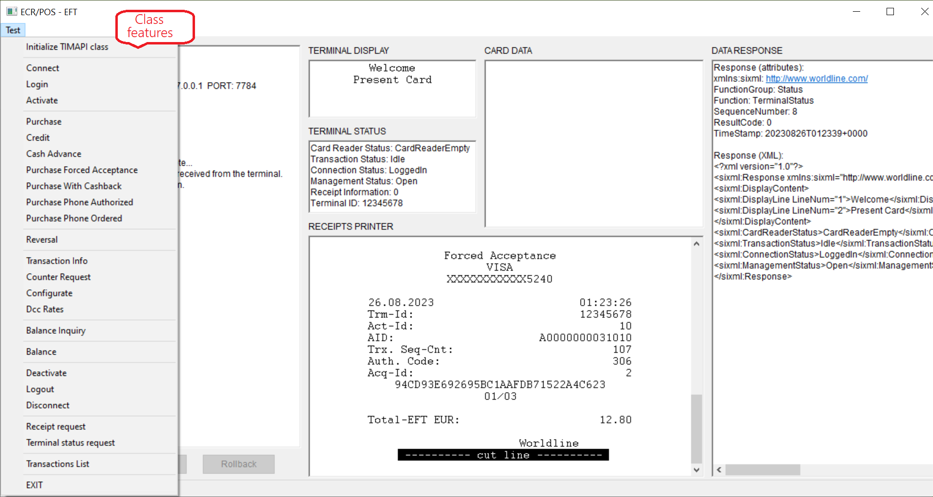

Re: Payment terminal TIMAPI.DLL
I started converting the code into a class. What other features do you think will be needed?
I am uploading the TIMAPI class with an example of use.
I also added new features. I am not attaching the description yet (there is no time to develop it) but I have included comments in the code. I think they will be helpful.

I solved it so far by creating an empty method with the given name
The transaction then proceeded correctly.
I am attaching a screenshot.
Log file after confirming the transaction
your_filenameok.zip
I am also testing other functions.
your_filenameok.zip
