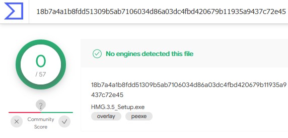

Re: HMG 3.5
I have seen three people complaining about virus in the setup exe file.
Any body who could download in Win10 64?

- Posts: 245
Re: HMG 3.5
Rathinagiri wrote: ↑Thu Nov 19, 2020 7:06 am I have seen three people complaining about virus in the setup exe file.
- Anotación 2020-11-19 093222.jpg (28.39 KiB) Viewed 32546 times
