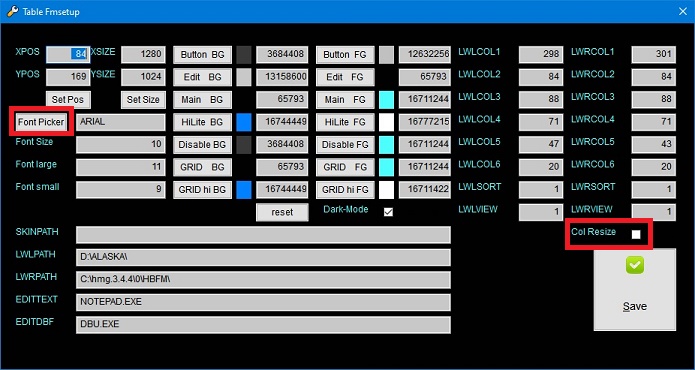

When re-size using LISTVIEW_SETCOLUMNWIDTH it is very slow on some PC.
so i have change Setup and add new Field in FMSETUP.DBF (Check will done automatic)
you can enable/disable use of LISTVIEW_SETCOLUMNWIDTH
fixed :
DELETE right side does not update Grid (left side work)
change :
FMSETUP.DBF add Field COLRESIZE "L"
FMSETUP Layout change
add new
Context Menu add sort, tree, sendto
CMDBox working (Del Key blockt ?)
Font Picker
Font-Name is for all, Font-Size is default, Font-Large for GRID / Listbox and Font-Small for Label in FMsetup.

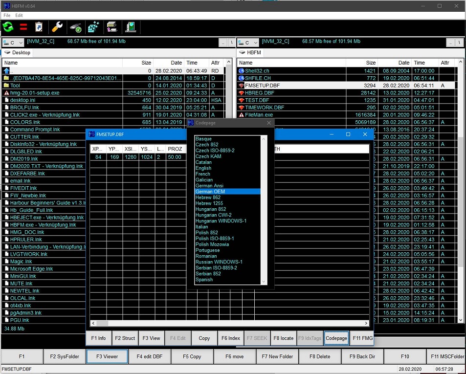

DBF Viewer F10 Codepage
Grid with Image :D
please have a look at Thread about Codepage
http://hmgforum.com/viewtopic.php?f=5&t=6350

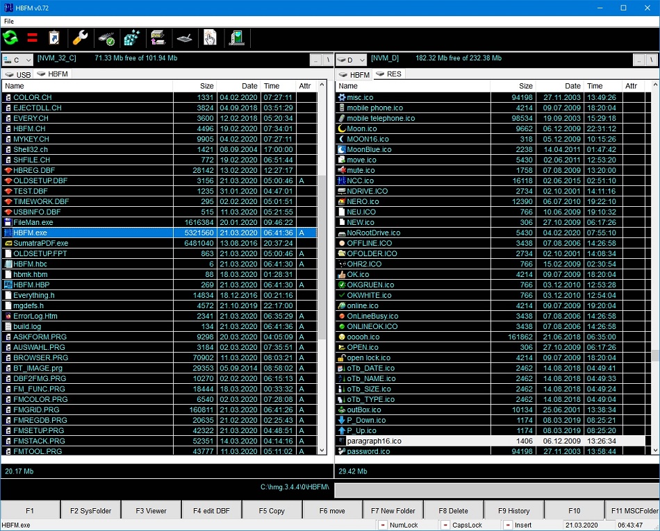

here latest Version 0.68
HBFM068.zip
(1.62 MiB) Downloaded 216 times
fixed :
Browser : F9 wrong Position when maximize
new :
*.LNK -> DXE_ResolveLink()
save / restore multi TAB (Array in Memo)
use Parameter /L /R to load TAB Directory. use # as Delimiter
HBFM.exe  /Le:\TEMP\#c:\hmg.3.4.4\0\HBFM\ /Rd:\ALASKA\SHFILE\#c:\hmg.3.4.4\0\USB\#f:\CT\
! Note : when using /L /R those TAB setting are not write to FMSETUP.DBF
p.s. FMSETUP.DBF will be automatic modify by this Update to store Array in Memo
