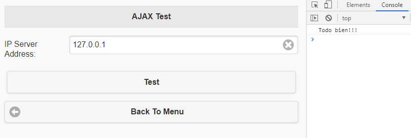

With a little more time, tests, enthusiasm and help from friends, we can move forward..., in this example I get the response from a Web Server Harbour (UHttpd) developed by a friend (also initial stage) and I discovered that JS is case sensitive.
function ajaxRead()
	var request = $.ajax( { url: "https://localhost:8001/tpy?login=javier&pass=123" } );
	request.done(function( data )
		//console.log( data )
		//console.log( data.cUserName )
		if(data.OK){
			console.log("Todo bien!!!");
		}else{
			console.log("Error...");
	request.fail(function(jqXHR, textStatus)
		alert( "Request failed: " + textStatus );
After this the idea would be to display the content, humm... I don't know maybe like tests in a jQuery dialog would be fine, but how to do it Roberto, any idea?.
