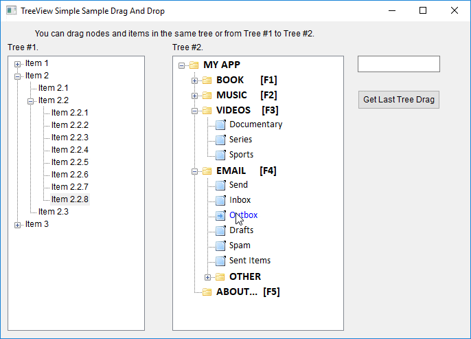

Can you put here small sample how to drag item from tree to textbox? I want to paste treeitem text to textbox and remember Id in another variable...
Re: Drag grid item to another grid
Posted: Thu Jan 10, 2019 7:39 pm
by edk
No problem.
The ability to drag from TextBox to Tree_2 with the right mouse button has also been added.
DragAndDrop_0.005b.zip
(12.16 KiB) Downloaded 461 times
Drag tree and textbox.gif (53.13 KiB) Viewed 21110 times

As promised here is the next version.
Added:
- support for Ctrl and Shift while dragging and dropping.
With the Shift key, you can move items by changing the position in the tree, with the Ctrl key we perform a copy operation.
- handling the context menu when dropping the right mouse button on tree # 2 (Copy / Move)
- handling the context menu of tree # 2 (on the tree item/node: Rename / Delete / Add as child ; in the empty tree space: Add New As Root )
- there is a new method for the tree: InsertItem
As I did not integrate this method with HMG sources, we call it as a function: _InsertItem (ControlName, FormName, cValue, nInsertPos, [aImage], [Id]).
Now you can build a tree using the context menu. :)
DragAndDrop_0.006.zip
(18.31 KiB) Downloaded 470 times
Enjoy.
