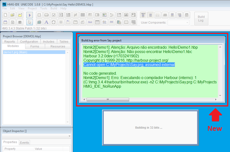

ChangeLog:
  1. For error messages (not errors in PRG), other errors like WINDRES or "undefined reference", for example, can be displayed in EditBox that allows the selection of text to be copied to the clipboard.
  2. This EditBox allows for resizing.
  3. You can change fontsize, background and font colors, both for displaying error messages and for displaying Grid PRG.
  4. New parameters like: /REMOVE and /CONFIG have been added to allow uninstallation and change of configuration.
  5. SetRegValueAsAdmin and ShutDown (See comments) functions have been added to ensure change in REGISTRY.
    I take the opportunity to clarify that using ViewError does not enforce access to REGISTRY.
    Only at the time of setup is accessed to configure an environment variable.
  6. Uninstall process was improved.
  7. To install the application, it is still the same as always: when clicking the app through Windows Explorer or at the command line (without any parameters).
<Attached files was removed because there is a newest version more ahead of this topic>
Note: (This added later) For those who were already user of the ViewError app, i.e. for those who already had it installed: it is recommended to delete the ViewError.ini from the current folder. This will create the file with new properties.
With the all continous help (by testing/reporting) will certainly help me to improve this app. I have been using it a long time and find it very useful and hope it serves the same purpose to all of you. The idea is to speed up the compilation process by showing the error in the text editor itself. Of course, using it is optional but your feedback interests me a lot.
