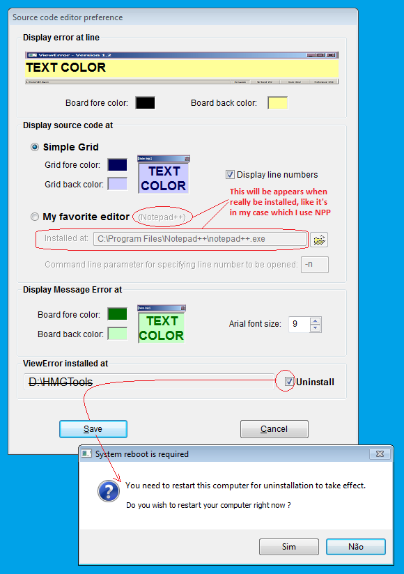

ViewError when run for the first time will create one .INI file in the current location of the executable. It will also create an environment variable where it will register where the application is located. This "if" you confirm in button "SAVE" (see picture below):
In this way Build.bat will recognize that there is an ERROR.LOG viewer application.
It is therefore recommended that you store this application in a more appropriate folder than the main directory.
I've stored it in a sub folder called HMGTools. (together with Call_IDE app) ;)
The uninstall option will only work if the application is actually configured. Hence it will delete the environment variable and will no longer work as ERROR.LOG viewer.
When you save the application, that is, configure the application. Take advantage of it and set it with the text editor "Notepad ++" (* #1) and leave the parameter "-n" that will go straight to the line where the error is occurring. This application makes a lot of progress in my compilations. Be it on the command line as well as in builds through the IDE.
Notes:
  • #1: Use Notepad++ option in ViewError only if you have installed already the Notepad++ in your computer, as your favorite source codes editor.
  • #2: You can install and configure another text editor. But configure it if this editor has the parameterization feature that when opening the editor can position itself in line # <nNumber_of_line> where the error occurs.
    If your favorite editor does not have this feature: let viewError working only through the "Grid as editor" option.

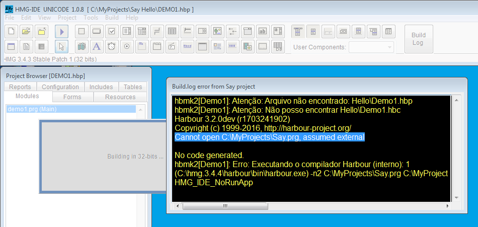

As I explained earlier, this application is intended to show and position itself in the line of your source code where the compilation error occurred.
This is working FINE ! :D
However, there are other types of errors that can occur during compilation and are often not related to the line of your code.
It is errors coming from HBMK2, WINDRES and even the operating system (permissions or memory errors, among others).
Now these errors can be viewed more comprehensively and in your code page of your current language (I believe), because these error messages were saved in OEM by HBMK2 (STD out) in my case in CP850.
This caused the non-display of accents in the Portuguese language (which is my case). Since this application can be used in several countries, in several languages I had to find a way to use hb_Translate with the correct and not fixed CodePage, then be able to find a function in harbour.

  1. For error messages (not errors in PRG), other errors like WINDRES or "undefined reference", for example, can be displayed in EditBox that allows the selection of text to be copied to the clipboard.
  2. This EditBox allows for resizing.
  3. You can change fontsize, background and font colors, both for displaying error messages and for displaying Grid PRG.

  • ShutDown. I want to explain the reason for using this procedure.
    When we create a fixed environment variable, not temporary, as it is in this case we can open one, two instances and as many as we want, the variable will always has the available value. But if we need to delete it or modify it, how to do with those instances already open and be able for updating variable in each one of it ? Therefore it is practical to request or force the boot of the equipment.
  • For example:
    1. Create an enviroment variable. (This video shows how to do: https://www.youtube.com/watch?v=bEroNNzqlF4)
    2. Lets say to open two instances of Prompt Command.
    3. In each Prompt window type: SET <Enter>
      Then you will see your variable that you have be created. Perfect upto now.
    4. Now you go again to system/environment variables a modify its value of same variable.
    5. Returning the two instances of Prompt, enter SET again.
      You will note that the variable it's still with the olf value.
      It's by this reason the system need to be booted.
  • In this case, when the application continues without the system being initialized, the same app behavior will persist because the variable is still in memory.
For this reason I have reinforced the messages so that the user is warned and that the installation or uninstallation procedure is finished.
