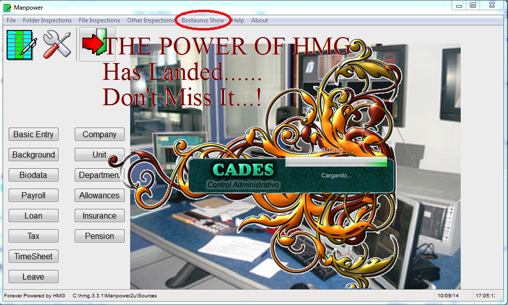

While working hard to revise source-progs to meet higher standard,
let's be relaxed.
Nothing wrong to include Bos Taurus Library to do exercises with drawing & images beside rigid numbers on Payroll.
let's be relaxed.
