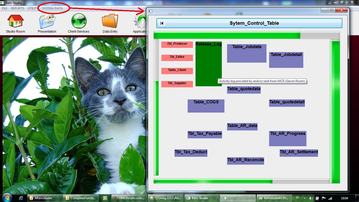

Rathinagiri wrote:
By the way, the software looks just great! What does this software do? Link all the programs or what?
1) The software I've been developing is a Front Office system for Ads-agency namely Production House and Post-Ediiting-Films/Video. Their jobs are to provide final video to release as Ads to appear on TV.
2) This screenshoot illustrates how databases are designed to cover the system-information need, in brief and simple way.
3) How do I develop? To begin with, I collected so many available samples of source program within HMG.3.3.1 folder, togather with several source programs shared in this forum. Then make them all work togather by adapting my needs. Last but not least, my old source programs written in CLIPPER-52e also combined in this project.
4) This prototype apps, for the the time being, takes many images availabe in SAMPLES folder to make it ASAP (as soon as possible). The most important thing is: I have've done exercises everyday with: GRID-CONTROL, WINDOW-CONTROL, MENUS-CONTROL, ACTIVEX, BOSTAURUS, RICHEDIT, PRINT-SYSTEM, BARCODE.... Everything not available in my past programming experinces with COBOL-BASIC-DATABASES.

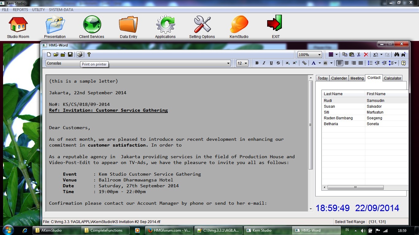

1) Frankly speaking, I can learn fast in HMG programming because of you (and all friends in this forum) support. That's way, only within 3 weeks I managed to build my own project which is applicable in my office. Although in fact I retired as a programmer some 10years ago and just made a comeback as per September 2014.
2) Continue to notify? Well... this screenshoot illustrates how I modified RicheditBox.prg to look more interesting when it comes with my software/apps. It's not finished yet, but represented the whole of my imagination. :) I wish somebody could tell me to find free modules in HMG for :mini Calculator.
Salam Hangat from Jakarta

Re: How To Help Clipper & Foxpro Users Catch Harbour-HMG ASA
Agil Abdullah wrote: 1) Frankly speaking, I can learn fast in HMG programming because of you (and all friends in this forum) support. That's way, only within 3 weeks I managed to build my own project which is applicable in my office. Although in fact I retired as a programmer some 10years ago and just made a comeback as per September 2014.
Very good !
Very nice !
With pleasure : viewtopic.php?f=9&t=1159

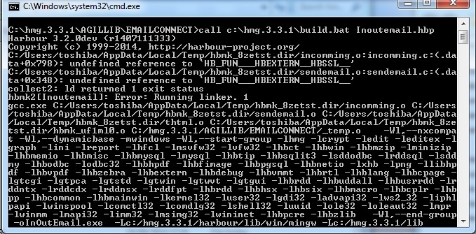

To: Javier Tovar & danielmaximiliano
I did download your attachments, but found the following error (see screenshoot):
I did :- copy from files your folder Includes into my HMG.3.3.1\include
- copy from files your folder Lib HMG.3.3.1 into my HMG.3.3.1\lib
- build : call c:\hmg.3.3.1\build.bat inoutemail.hbp
Then error found. I am using 32bit.
Pls tell me what's wrong with that.
