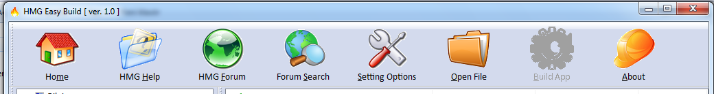

And I have a new suggestion with a new SEARCH_FORUM module :
New toolbar for Easy Build

      DEFINE TOOLBAR ToolBar_1 BUTTONSIZE 120,95 IMAGESIZE 64,64 STRICTWIDTH FLAT
         BUTTON Button_1 CAPTION "Ho&me"            PICTURE '_home'      ACTION URL_OPEN ( URL_BLOG  ) TOOLTIP 'Home page ...'
         BUTTON Button_3 CAPTION "HMG &Help"        PICTURE '_help'      ACTION URL_OPEN ( cHMG_Help ) TOOLTIP 'Open HMG Help'
         BUTTON Button_2 CAPTION "HMG &Forum"       PICTURE '_ftp'       ACTION URL_OPEN ( URL_FORUM ) TOOLTIP 'Open HMG Forum'
         BUTTON Button_8 CAPTION "Forum &Search "   PICTURE '_FrmSearch' ACTION SEARCH_FORUM() TOOLTIP 'Search at HMG Forum'
         BUTTON Button_4 CAPTION "&Setting Options" PICTURE '_setting'   ACTION SETTING_OPTIONS()      TOOLTIP 'Setting Options'
         BUTTON Button_5 CAPTION "&Open File"       PICTURE '_open'      ACTION OPEN_FILE()            TOOLTIP 'Open File'
         BUTTON Button_6 CAPTION "&Build App"       PICTURE '_build'     ACTION BUILD_APP()            TOOLTIP 'Build .HBP/.PRG Files'
         BUTTON Button_7 CAPTION "&About"           PICTURE '_about'     ACTION ABOUT_INFO()           TOOLTIP 'About ...'
      END TOOLBAR

In my opinion there isn't any reason to limit search for samples.
Only a humble suggestion and only my personal view of point; the decision is to you :arrow:

esgici wrote:I couldn't understand how my suggestion was an obstacle to work properly SEARCH_OPEN module of Toledo
In my initial code SEARCH_OPEN, was using Form_1.StatusBar.Item (1) to get the current open folder, but your suggestion included the name of the selected file, then the only way out was to use Form_1.Tree_1.Cargo (Form_1.Tree_1.Value)).
esgici wrote:In my opinion there isn't any reason to limit search for samples.
The HMG Easy Build can be used to compile the demos of the SAMPLES folder, but can also build any other project HMG in other folders. So I thought it best to limit SEARCH_OPEN only when the SAMPLES folder is selected. So the search will be based on the selected folder, searching forum function / events / controls related to the current folder.
When any folder is selected, different SAMPLES, the button HMG Forum will open http://www.hmgforum.com" onclick="window.open(this.href);return false;.
esgici wrote:And I have a new suggestion with a new SEARCH_FORUM module
I noticed that in your module SEARCH_FORUM you are using the file name selected to search forum. Most names of PRG files or HBP is demo (Demo.prg, demo1.prg, demo2.prg, etc), then the forum will search by name "demo", no matter which folder is selected.
I think the correct approach would be to search for the name of the selected folder, as I did SEARCH_OPEN.
