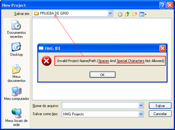

Today when I tried to compile Agustin example (project in folder which contains spaces characters) I found this problem:
Then I remembered about this message.
I think most of us have passed for this experience and I believe there is solution for this. At least I got it the right way to compile thru Build.bat at prompt of line command without problem (as show in my message of link above).
The question is: Is possible Claudio Soto to make workable also at HMG/IDE ? Do you believe we can find any problem to do it so ? Please comment.

Pablo César wrote:The question is: Is possible Claudio Soto to make workable also at HMG/IDE ? Do you believe we can find any problem to do it so ? Please comment.
Sorry Pablo, but I have no time to dedicate to the IDE.
HMG 3.2 (Stable)
No problem my friend, I understand. I would like to help you, because seems not be difficult to be implemented at IDE also at Build.bat. In case you need more details, please be free to ask me when you are able to do it. ;)
