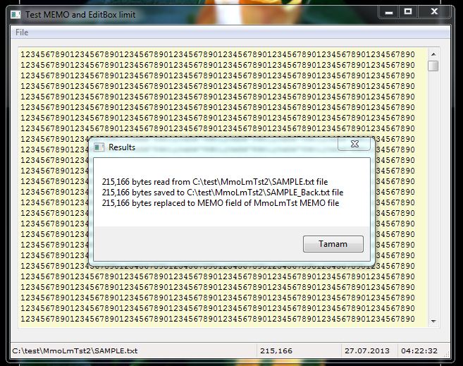

Now you need follow instructions of our doc at the beginning of topic; in summary :
#define EM_LIMITTEXT 197
SendMessage (GetControlHandle("EditBox_1","Form_1"), EM_LIMITTEXT, 0, 0)
MSG_SETTEXT (GetControlHandle("EditBox_1","Form_1"), cHugeText)
cHugeText := MSG_GETTEXT (GetControlHandle("EditBox_1","Form_1"))
and add a "small" #pragma to your program :mrgreen:
Or simply follow my slightly modified sample :
Memo limits and EditBox capacity test results
MmoLmTst2.zip
Memo limits and EditBox capacity tests Sources
(136 Bytes) Downloaded 311 times
Viva HMG, viva Roberto Lopez, viva Dr. Claudio Soto :D

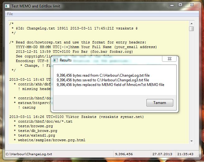

Posted: Sat Jul 27, 2013 7:31 pm
srvet_claudio wrote: Yes, is correct!!!
Well,
this is rectified ( 3rth ) version of test prg
MmoLmTst3.zip
(2.08 KiB) Downloaded 467 times
Enjoy !
