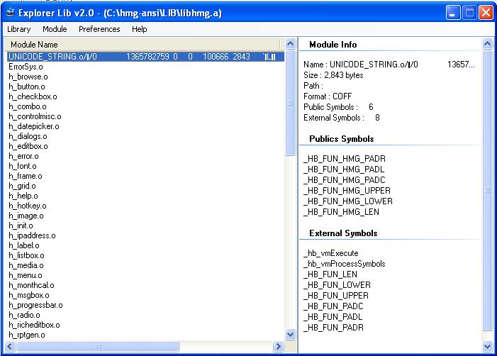

Muchas gracias Dr. Claudio para que esto esté arreglado. :D Now, it is working fine.
I have explored the generated libhmg.a using http://codigo-base.blogspot.com/search/ ... orer%20Lib
There are strange code attached to unicode_string.o in libhmg.a One possibility is that Explorer Lib does not support unicode. It seems its not a big deal though as long as the Public symbols, external symbols and COFF format is recognized. Other HMG objects are ok. This condition is the same between HMG Unicode Enabled and HMG ANSI build. See attached.
Thank you very much again for the fixed.

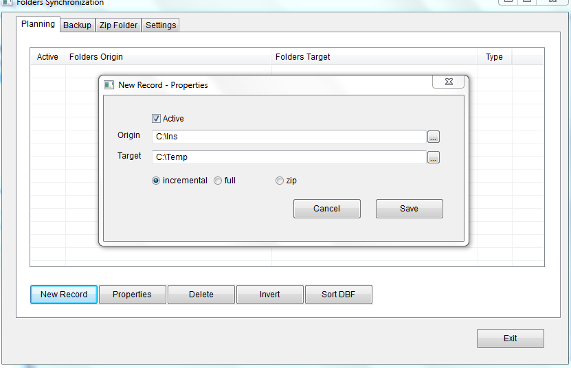

I post a little video at first compilation the text_box contros works well, bud at the second try it fails
Prueba error.rar
(381.98 KiB) Downloaded 879 times
thanks,
Ed

Save button execute the next code:
cTemp:=GetProperty('Win2','Text_1a','Value')
msgbox(alltrim(cTemp)+"x")
But in a randomly manner the value is not returned, sometimes msgbox shows: "Pruebax"

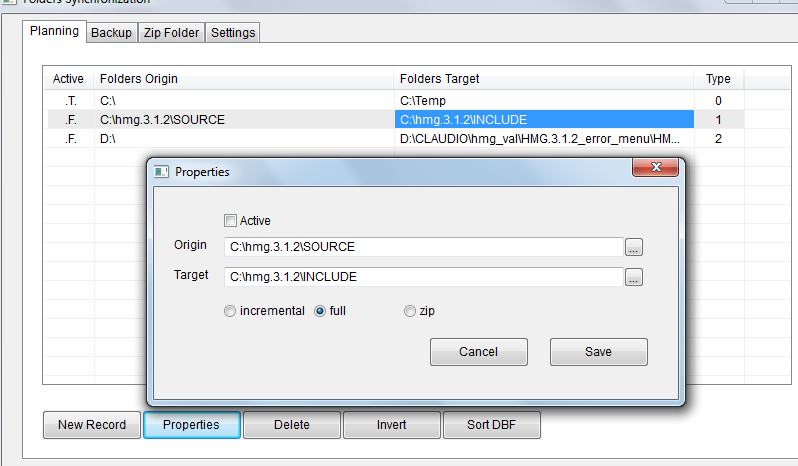

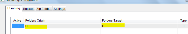

HMG_MYSYNC.rar
(8.22 KiB) Downloaded 846 times
, the text_box controls work well bud something happend with the grid that doesn´t show correctly the content
It should be "C:\Ins\" and not "H"
Sorry to bother you with that but the issues with the text_box is a problem.

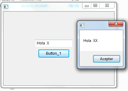

Sorry, to be recurrent but even in this little example the textbox control fails
Atacched please find complied example (.exe)
prueba0.rar
(765.08 KiB) Downloaded 932 times

Steed
Posts: 454
Re: HMG 3.1.2 (Test)
Post by Steed »
Gracias, leopoldo
Probaste con el .exe que envié adjunto ?
si no, podiras probar con el exe adjunto, sin compilar en tu maquina.
cuando haces click en el boton deberia motrar el contenido del label+"x" pero ami solo me muestra la "x"
Algunas veces ejecuta bien, pero si la cierro y la ejecuto nuevamente comienza a fallar
Gracias,
Ed
