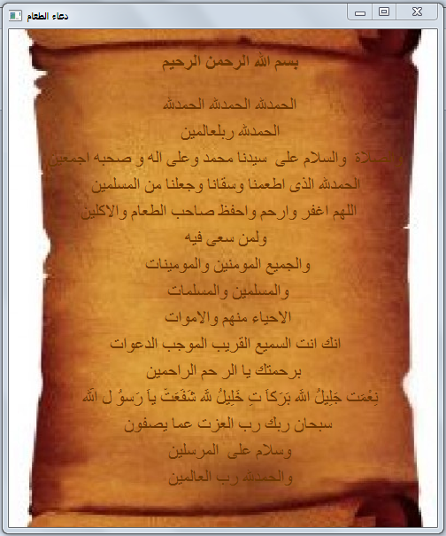

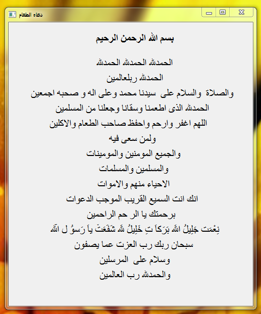

So, this is my humble work:
I'm not sure it's useful or not :?
Viva HMG, viva Mr. Diamond, viva Dr. Soto :D
HMG-UT8 sample in Arabic Language - Screen Shoot

Re: HMG 3.1.0 (Test)
esgici wrote:So, this is my humble work:
WOW, Brother.
Is beautiful !!!
Is like a work of art hand painted. :D
srvet_claudio wrote:Is like a work of art hand painted. :D
Thanks Dr.
I didn't made anything special:
  • - Write in MS-Word,
    - Copy and paste to Notepad,
    - Save as UT8
that's all.
Everything made by HMG, that is by you ;)
Hearty thanks again.
With my best regards :D
This ancient manuscript was found by archaeologist Mr. Esgici in the mountains of Turkey. :o
Esgici_duaitaam.rar
(49.59 KiB) Downloaded 1034 times

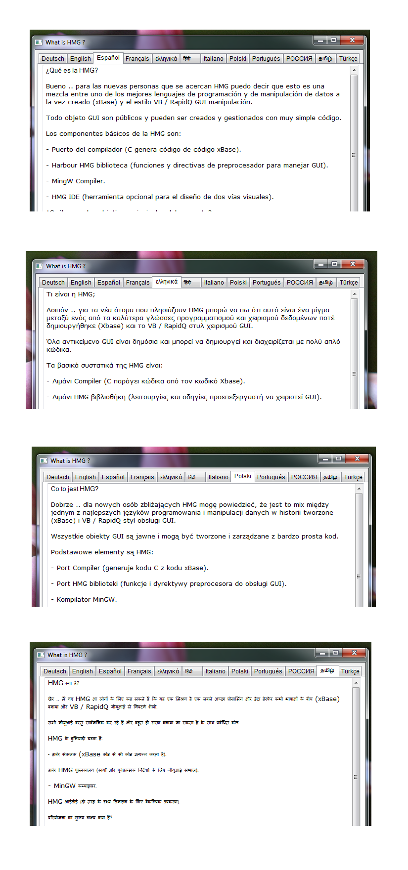

Well,
nobody come with me :(
( to explore wonderful world of Unicode ;) )
This is famous article of our Maestro in 12 language together :arrow:
None LangSelect, none Set_CodePage etc ...
( Translator is Google; I'm innocent ;) )
What is HMG in 12 Language, Screen shoots
WhatIsHMG.zip
What is HMG in 12 Language, Source files
(8.26 KiB) Downloaded 1340 times
esgici wrote:
( to explore wonderful word of Unicode ;) )
WOW, wonderful, HMG-UNICODE is the best :D
Goodbye, goodbye, goodbye problems with Set_CodePage :D :D :D
