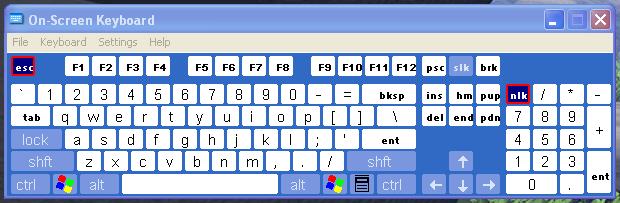

How to display the virtual keyboard ?
Re: RICHEDITBOX
srvet_claudio wrote: ...I will include these functions in the new release of HMG.
It will be very good :)
There is a short key In Start Menu\All Programs and .exe is : %windir%\system32\osk.exe
More, if you close Windows without closing Virtual Keyboard, it will open next startup automatically.
I guess it will be possible to activate it ( by run / shell commands ) within our programs :?
Thanks again for this convenience :)
Regards :D

That is cool !
EXECUTE FILE GetSystemDir()+"\osk.exe"
Re: RICHEDITBOX
srvet_claudio wrote: That is cool !
Coolest is you !
Thanks to tip 8-)

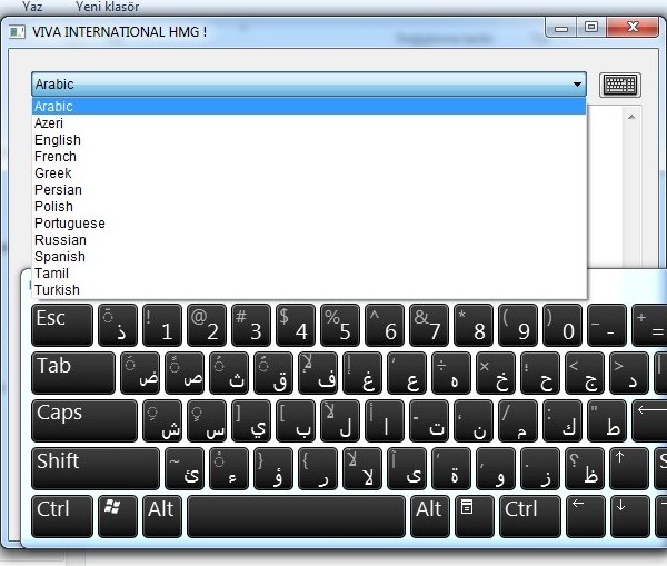

Added keyboard activation button !
Added also some languges ( of friends )
and some low-level rutine was simplified ( please confirm )
UI_Lang_02.zip
UI Lang select - II
(1.95 KiB) Downloaded 296 times
UI Lang select II screen shoot
A little note for friends :
In order to use this feature, you need install UI languages ( keyboards ) via Control panel. Check installed keyboards in "Language" bar of task-bar.

srvet_claudio wrote:Enjoy !
Wonderful :!:
Now, the Virtual Keyboard is completly under control :arrow:
Thank a lot doc :)
