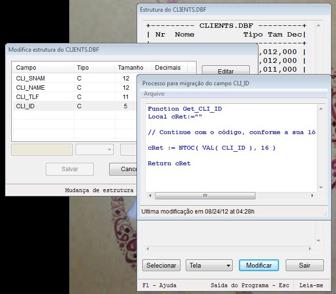

Pablo César wrote:
esgici wrote:User defined conversion "processos" not working yet, is this correct ?
Ohh yes it is working !
Apparently I can't run it without translation :(
Translations... just strings... ;) (I will start tomorrow, I promess to you dear Esgici !)
Pablo César wrote:Remember, you will need to make your own source code inside that EditBox and save your text with "Gravar" in menu item. Then you can "Salvar" just for apply modifications.
Sorry, after "Gravar" editbox, "Salvar" always left disabled :(
Pablo César wrote:Translations... just strings... ;) (I will start tomorrow, I promess to you dear Esgici !)
Please ...
I'm wondering really, how you will execute an User Defined Function at run time :o
Esgici wrote:Sorry, after "Gravar" editbox, "Salvar" always left disabled
You so right, amigo Esgici. Even if no structure changing was made and any process has been changed, at least must allow for save "Salvar". Sorry was missing enabling "Salvar" button. Also was corrected a path+new name of dbf that is directly connected with the same name of prg which must compile & execute in runtime. Another think, when any changing is made (not structural) only data by processes, STRU should has not to be mention of any changing, so was needing to check structural of before and after saving.
Esgici wrote:I'm wondering really, how you will execute an User Defined Function at run time
Sorry, amigo was not detecting prg files then was not executing. Now it is working ! :oops:
This correction, are so important and delayed a little bit more (next week I will start) for translations demands.
Thank you Mr. Esgici for you observations. :)
Another bug was found by our colleague Jairo Maia at Clipper on line forum, that STRU does taking effects when decimals are changing. Also appointed that decimals must to be upto 8 as maximum range in the second Spinner. Now it is corrected, now in attached file.
Obrigado Jairo pela sua observação !
<Attached file removed, see last message with now release>
