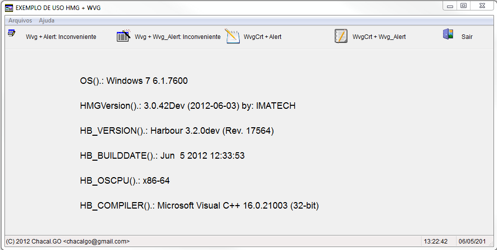

HMG 3.0.41: Compilling With MSVC: Success
Post by IMATECH »
C:\HMG>buildlib_msvc.bat
Setting environment for using Microsoft Visual Studio 2010 x86 tools.
hbmk2: Processando opções do ambiente: -compiler=msvc
hbmk2: Compilando...
... warning messages ...c
hbmk2: Criando biblioteca estáticas... lib\hmg.lib
* Build Success
* hbwinole.h must be in \include
hbwinole.h
* Changes needed on file: c_toolbar.c
Added code on line 70: #ifdef __GNUC__
Added code on line 88: #endif

* Changes needed on file: c_windows.c
Added code on line 1090: {
Added code on line 1097: }
HB_FUNC ( SETGRIDQUERYDATA )
	char c [1024] ;
	strcpy ( c , hb_parc(2) ) ;
	LV_DISPINFO* pDispInfo = (LV_DISPINFO*)hb_parnl(1);
	pDispInfo->item.pszText = c;
.<br />.exe file built with Msvc<br />.<br />Hmg + Wvg<br />.
Hmg + Wvg

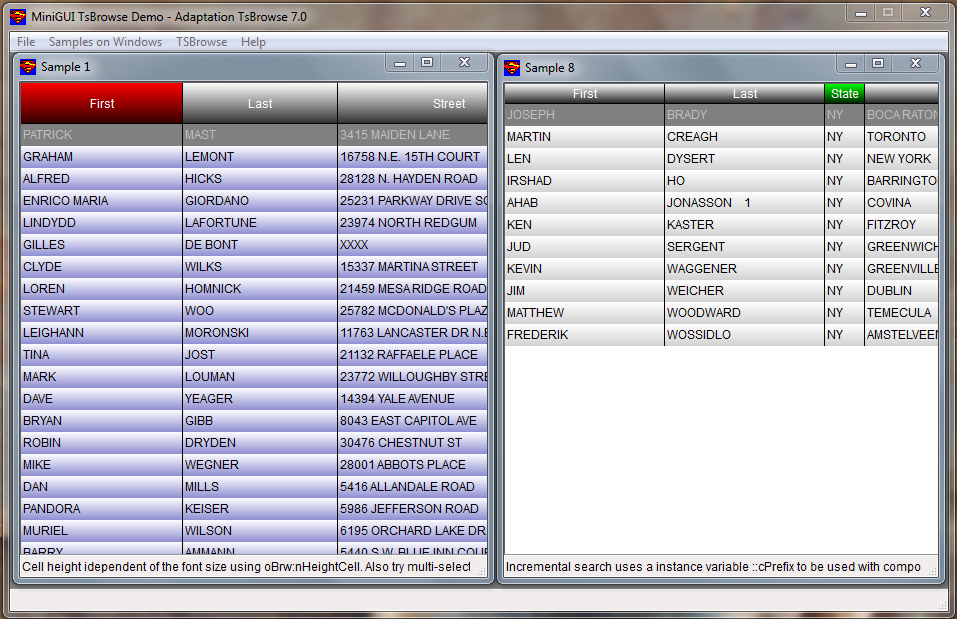

New updates done (Just testing)...
Now Hmg can compile all libs with mingw/msvc...
Optional:
TsBrowse 7 Added: Thanks to Grigory Filatov
To enable/disable it:
Just edit minigui.ch and comment/uncomment the line
#define COMPILE_TBROWSE
About this Work:
I have switched all warnings to w1 (force implicit var declaration), and made minor changes in source code only for declare some true local var (all changes documented in souce code)...
The core of HMG is perfec: just a few lines added...
Result := All lib's will compile with warning level 1 -w1

TsBrowse: Just for tests and is Optional in [minigui.ch]<br />.<br />#define COMPILE_TBROWSE<br />.
