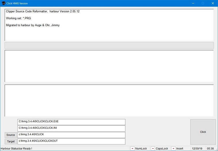

got it run in GUI Mode with different Directory for Source / Target
after Start CLICK.EXE it will create CLICK.INI
i have change to RUNMODE=S87 and VERBOSE=YES
if you want it Quick use VERBOSE=NO
so here is CLICK.EXE
HMG_CLICK_GUI.zip
(1.29 MiB) Downloaded 424 times
let me some time to clean up Code which is not need any more under GUI.

unpack all to a Folder, start IDE and load CLICK.HBP
! Note : if you have a old CLICK.HBP delete PRB_STAK.PRG from Filelist
also CLICK.hbc is not need any more.
when CLICK.EXE start 1st time it will create CLICK.INI
CASE_OF_COMMANDS=UPPER
CASE_OF_FUNCTIONS=UPPER
CASE_OF_BOOLEAN=UPPER
INDENT_FUNCTIONS=YES
INDENT_DO_CASE=YES
INDENT_LOCALS=NO
VERBOSE=YES
RUNMODE=S87
ALIGN_CLASS_IN_THE_ALIGNER=NO
If you want it QUICK without Output use
VERBOSE=NO
using RUNMODE=S87 will automatic disable PREPROCESS_WITH_DECLARATION_BUSTER
Option ALIGN_CLASS_IN_THE_ALIGNER is for Classy Style so you have to check if it work with harbour Style
so run CLICK on Click Source Code and tell me how long it take on "your" PC
HB_CLICK_SOURCE.zip
(63.04 KiB) Downloaded 396 times
todo : DBF Table and Index still report from CLICK.EXE Folder ... (might be in different Directory than Source )
