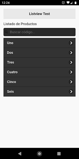

Some time ago I also did tests with JMG, it's amazing simplicity and abstraction to introduce us "Newbies" to the real world web, even as tests I added the Listview widget very rudimentarily and apparently it worked...
(in fact this image is from the JMG demo taken from my android mobile phone, it was converted as Roberto commented at that time with Website2APK builder)
